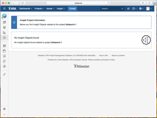

1. I have the Insight up and running, but on my Jira project the Add-on tab is empty:
Would it be possible to get some sort of "mini connection" to insight in this view ? So that the agents do not need to bounce between the Jira Project and Insight schema when they are searching for related information ?

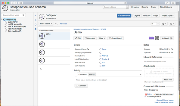

2. Is there any way that I could open new Jira ticket from the Insight view? When the service desk agent goes insight to check the history of the machine to gain some insight about the issue at hand, it would be convient to open new issue right from the issue history and have the object pre-selected instead of going trough the whole referenced object tree.
Also - If I make labels for each device the barcode points to the insight Object view. so it would be convince to read the barcode -> check the machine history -> open new issue.

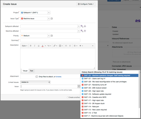

4. When I'm creating new issue and linking it to previous issue. Is it possible to get some insight object data to this list? (picture bellow). Now when connecting the issues - I first need to go to the insight Schema and search the device, then note the issue number, go back to the ticket creation and choose the right issue.

1. Would it be possible to get some sort of "mini connection" to insight in this view ? So that the agents do not need to bounce between the Jira Project and Insight schema when they are searching for related information ?
What is displayed on this tab is the objects in Insight, that has an attribute of type project, that is set to this Project. It's not listing the objects selected in custom fields in this project, just so that it's clear what's expected.
If you want to see what Insight objects that are connected to Jira Issues, there are different solutions.
One example is on the Issue search in JIRA to search based on the Insight custom field.
In Insight it's possible when you are looking at specific object types to search based on if the object has an jira issue connected using the connectedJiraIssues() function which is covered in https://documentation.riada.se/insight/latest/insight-user-s-guide/iql-insight-query-language
It's not possible to open an issue based on an Insight object, where an custom field would be preselected with that object.
I would like to recommend you to visit https://jira.riada.se which is our open ticket system for feature requests and verified bugs. You can view, watch, vote etc for issues reported by anyone.
If you can't find an already opened feature request for this, feel free to create a new one.
This is not possible, it's basically the same for any field, they won't get populated based on an linked issue.
