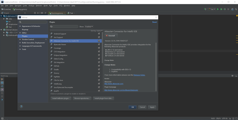

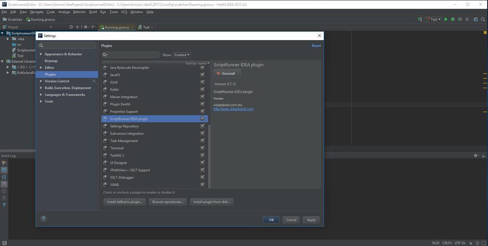

Hello, thank you for replying.
So I have the Atlassian connector, and the script runner plugin installed. Below are some images, showing the connector and plugin installed for the IDEA, and then the error I get from the scriptrunner console when I click on the circled button.
