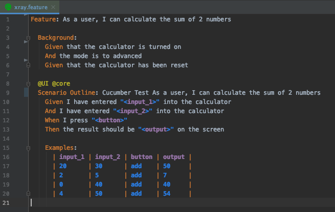

Then we try to import an existing and simple feature file by using the rest api:

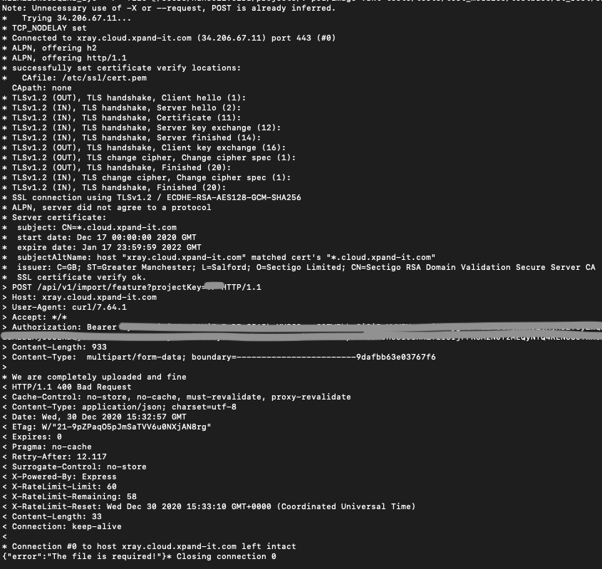

curl -H "Content-Type: multipart/form-data" -X POST -H "Authorization: Bearer <token>" -F "file=@<absolute path>/xray.feature" https://xray.cloud.xpand-it.com/api/v1/import/feature?projectKey=<our xray project key> -v
The response is "The file is required".
We have tried multiple ways but the response is always the same and there's no clue regarding what's wrong.

curl -H "Content-Type: multipart/form-data" -F file=@features.zip -H "Authorization: Bearer <REMOVED>" https://xray.cloud.xpand-it.com/api/v1/import/feature\?projectKey\=<REMOVED>\&source\=<REMOVED> -v
* Trying 52.7.228.161:443...
* Connected to xray.cloud.xpand-it.com (52.7.228.161) port 443 (#0)
* ALPN, offering h2
* ALPN, offering http/1.1
* successfully set certificate verify locations:
* CAfile: /etc/ssl/cert.pem
* CApath: none
* TLSv1.2 (OUT), TLS handshake, Client hello (1):
* TLSv1.2 (IN), TLS handshake, Server hello (2):
* TLSv1.2 (IN), TLS handshake, Certificate (11):
* TLSv1.2 (IN), TLS handshake, Server key exchange (12):
* TLSv1.2 (IN), TLS handshake, Server finished (14):
* TLSv1.2 (OUT), TLS handshake, Client key exchange (16):
* TLSv1.2 (OUT), TLS change cipher, Change cipher spec (1):
* TLSv1.2 (OUT), TLS handshake, Finished (20):
* TLSv1.2 (IN), TLS change cipher, Change cipher spec (1):
* TLSv1.2 (IN), TLS handshake, Finished (20):
* SSL connection using TLSv1.2 / ECDHE-RSA-AES128-GCM-SHA256
* ALPN, server did not agree to a protocol
* Server certificate:
* subject: CN=*.cloud.xpand-it.com
* start date: Dec 17 00:00:00 2020 GMT
* expire date: Jan 17 23:59:59 2022 GMT
* subjectAltName: host "xray.cloud.xpand-it.com" matched cert's "*.cloud.xpand-it.com"
* issuer: C=GB; ST=Greater Manchester; L=Salford; O=Sectigo Limited; CN=Sectigo RSA Domain Validation Secure Server CA
* SSL certificate verify ok.
> POST /api/v1/import/feature?projectKey=<REMOVED>&source=<REMOVED> HTTP/1.1
> Host: xray.cloud.xpand-it.com
> User-Agent: curl/7.77.0
> Accept: */*
> Content-Length: 15306
> Content-Type:  multipart/form-data; boundary=------------------------fe356ce82ce1f9af
* We are completely uploaded and fine
* Mark bundle as not supporting multiuse
< HTTP/1.1 400 Bad Request
< Cache-Control: no-store, no-cache, must-revalidate, proxy-revalidate
< Content-Type: application/json; charset=utf-8
< Date: Tue, 04 Jan 2022 16:25:15 GMT
< ETag: W/"21-9pZPaqO5pJmSaTVV6u0NXjAN8rg"
< Expires: 0
< Pragma: no-cache
< Retry-After: 60
< Surrogate-Control: no-store
< X-Powered-By: Express
< X-RateLimit-Limit: 60
< X-RateLimit-Remaining: 59
< X-RateLimit-Reset: Tue Jan 04 2022 16:26:15 GMT+0000 (Coordinated Universal Time)
< Content-Length: 33
< Connection: keep-alive
* Connection #0 to host xray.cloud.xpand-it.com left intact
{"error":"The file is required!"}%
