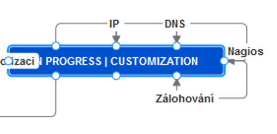

Tomáš Vrabec
August 23, 2019
Hi @David Fischer  its intended.
Attaching screen of transitions in workflow.
screenshot 25.pngEach transition generating different sub-task type.
Each transition got the same mentioned condition.
When I create "Server Config IP" subtask, first transition is hiding as expected.
When I create all of three others, transitions are still shown, even condition is very the same, just with different getName comparison.
Working on workaround via custom fields, but still this would be nicer solution.

If I understand correctly, you want each transition to be visible (available) only if there is no corresponding subtask, correct? In that case, your condition should be:
!issue.get("subtasks")?.any{it.getIssueType().getName() == "Server Config IP"}
(note the leading ! and the ==)
which means "there is no subtask whose issue type is Server Config IP"

Tomáš Vrabec
August 26, 2019
Yep, that did the job. Thanks David and have a nice day!
