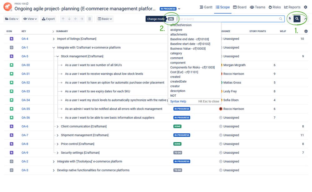

Hi Danny
Yes, you can use JQL withing BigPicture modules, just 1. press the magnifying glass button, and then 2. change the mode from TXT to JQL, as evident in the below screen capture.

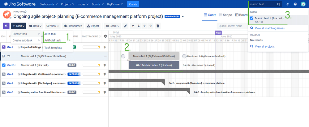

Yes, you can search BigPicture issues from within Jira context, as long as you created those issues using Task > Create task > JIRA task, see 1. in the screenshot below. If, however, you hit the 'Artificial task', then, although such an artificial task is represented by a bar on Gantt chart's timeline (2.), Jira search cannot see it (3.).

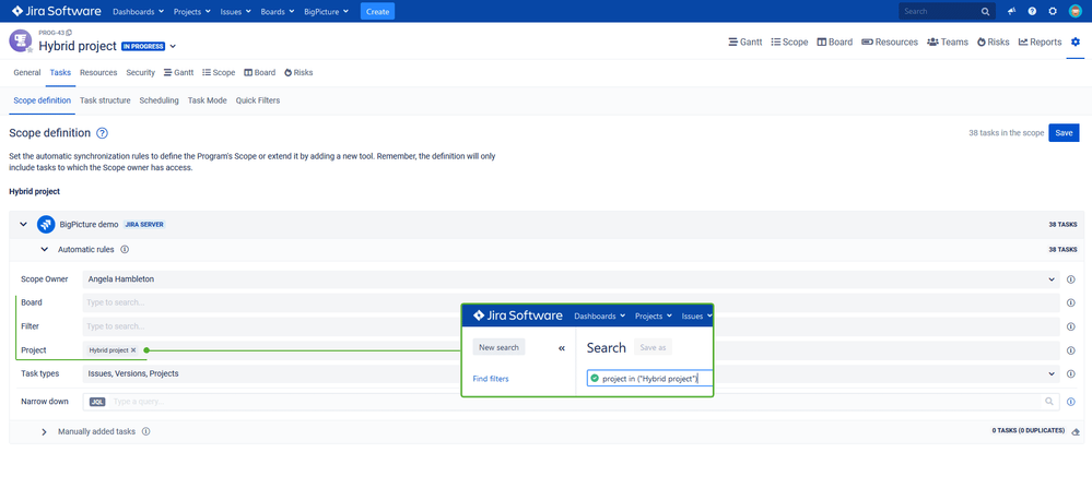

Hello Danny,
this is an interesting case. Unless our support team finds a nicer solution, I'd go to the BigPicture program's configuration and check its "filtering", and then I'd try to recreate those filters in Jira's JQL field.
In this case it's easy: project in ("Hybrid Project")
or even better: project = "Hybrid project"
