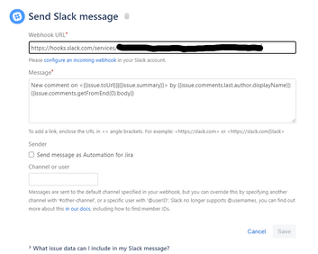

We're not finding the "Channel" override to work, so we've created a new hook for each channel which is building a lot of complexity. It seems we should be able to put "#channel_name_here" in the box and it would work. I'm curious if we're using it incorrectly or if we don't have the right hook URL set properly.
The hook url is:
https://hooks.slack.com/services/xxxxxxxx/xxxxxx/xxxxxxxxxxxxxxxxxxxx
Can anyone shed light on the override box? Thanks.

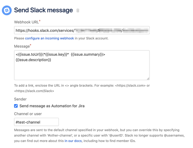

This is a bit curious, as we do expect the override to work as you described. Here's an example of an Automation rule I'm using that is currently sending messages to my override channel:
The hook format you listed looks correct (especially if you configured it with the link provided there in the configuration page). I've tested with a private channel for the override and still received the message when the rule was triggered. There's also no configurable settings on the webhook on the Slack end that would prevent an override from occurring.
I'm curious if you could try the override once more and note the time when you give it a go. If it doesn't post again, we can open a support case and investigate based on that rule execution.
