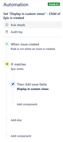

For the time being, I have achieved this using two automated actions:
You can see I update the Epic's child issues if I change the field in the Epic, and I also update the field in the child when I create a child issue.  I dont like this method because there are so many ways to create/update issues and I have to create an automated action for each use-case.
