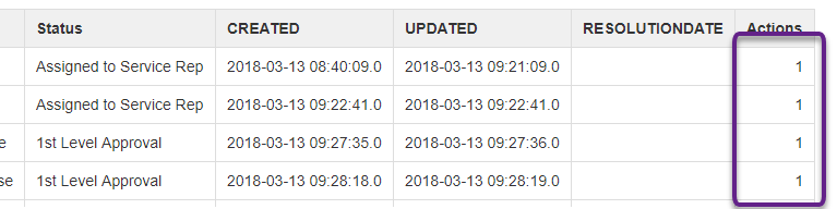

I am using the Bob swift SQL and Run macros to pull data and using https://bobswift.atlassian.net/wiki/spaces/RUN/pages/8486925/How+to+do+SQL+database+operations+on+lists+of+data. It has been a while, but for some reason I am not getting the button to properly display. I am getting "1" in the column.
To try and narrow things down, I removed the encoding logic to see if I could get the button to populate, but no change.

My results:
  query results.pngIt has been a while since using the macros, so any help will be greatly appreciated.

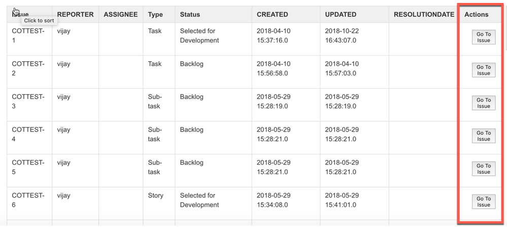

Hi @Thomas Hardin,
We tried the same which you have provided and we were able to make it work by using CONCAT next to {run1:id =e' and resplaced "||" with ,. Also had corrected the
project.pname = '$proj'
instead of using project.pname = '\$proj'
Please see the storage format of the sample which we tried.

 Please see the below screenshot which shows the example is working as expected.
