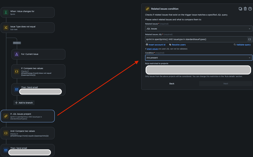

This is what I setup,
We only wanted to be notified for non-sub-tasks when new issues left or came in on the  current open sprints

Pierre Liddle May 2, 2024
@Lucas Ferreira I'm not sure if this would help, but I'm showing the one extra condition in the flow that wasn't in the previous screenshot. I can't recall why, but I see we turned this off, and it might be related to the issue you're describing.

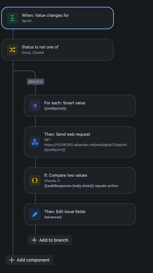

Late to the party, but if anyone comes across this and might be interested, here's a solution for Cloud that's a bit simpler than @Johnny Mon's wonderfully comprehensive one.
Johnny is right that OpenSprints() is NULL, so it didn't work properly for us. We needed to use the fieldChange value, but there are potentially multiple sprints, so we have to iterate. But instead of math and sets, you can use Advanced Branching and only five or six steps total.
Here's how:
  1. Add WHEN field value changes trigger for Sprint, with change type Value deleted
  2. (optional) Add IF condition(s) to exclude issues with Done status, or whatever else to your taste
  3. Add a branch with Advanced branching to create a For each: Smart value.
    • Use this for the smart value, to remove spaces and create an array from the string listing the "old" sprint(s) IDs:
      {{fieldChange.from.replace(" ", "").split(',')}}
    • Set a variable that will be used for subsequent components (API requests), like "oldSprint". If {{oldSprint}} has multiple values, the later components in that branch will execute multiple times, using each individual value once.
  4. Within that branch, add a Then: Send web request to get info about the sprint(s)
    • Web request URL (don't forget to use your own org's domain):
       https://YOUR_ORG.atlassian.net/rest/agile/1.0/sprint/{{oldSprint}}
    • HTTP method GET, empty body
    • Delay subsequent execution ✔
    • Add a header with: key "Authorization", and value "Bearer " or "Basic " then your API token, encoded accordingly
    • Validate your request to make sure auth works, but remember it won't have a value set for the oldSprint variable, so it won't return proper data.
  5. Still in that branch, add an IF: Compare Two Values with these values to check the current open/closed/future state of the sprint(s): {{webResponse.body.state}} "equals" "active"
  6. Still in that branch, add another Web Request for Slack with appropriate messaging.
I just wanted to track churn over time, so instead of calling another service, I just I added labels with an advanced field edit, to add "churn-{{year}}_{{name of sprint}}" and "removed-from-sprint":
"update": {
"labels": [{
"add": "churn-{{now.format("yy")}}_{{webResponse.body.name.replaceAll(" ","_")}}"
"add": "removed-from-sprint"
Hope this helps someone!

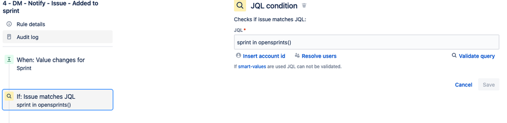

This works for "added to current sprint":

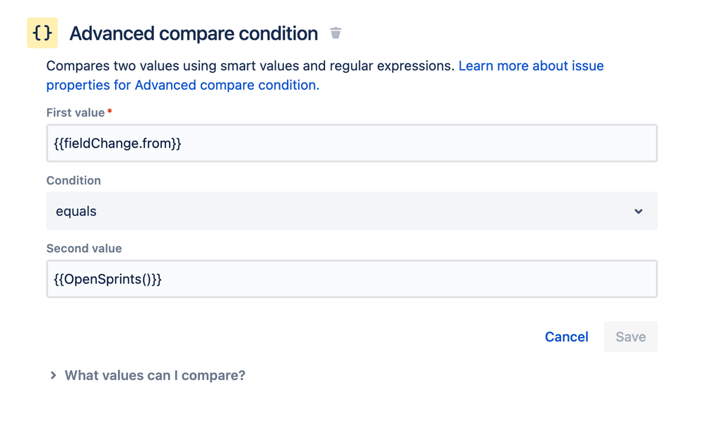

I also want to clarify that the Smart Value {{OpenSprints()}} will always return EMPTY (NULL), because we can't directly call the JQL function in a Smart Value expression.
So, the expression
{{fieldChange.from}} equals {{OpenSprints()}}
       is the same as
{{fieldChange.from}} equals NULL
Therefore, we will get notification when an issue is removed from active or future sprint.
