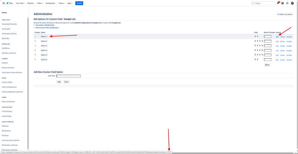

Firstly, you will need to gather some information, i.e. the custom field's id, which you appear to have acquired and next, the ids for the custom field values.
1. Edit the Options for the List you intend to filter
2. Move your mouse over the Edit link. You can view the Option's ID as shown in the browser footer in the screenshot below.
You will need to use the information above to filter the option for the select list.

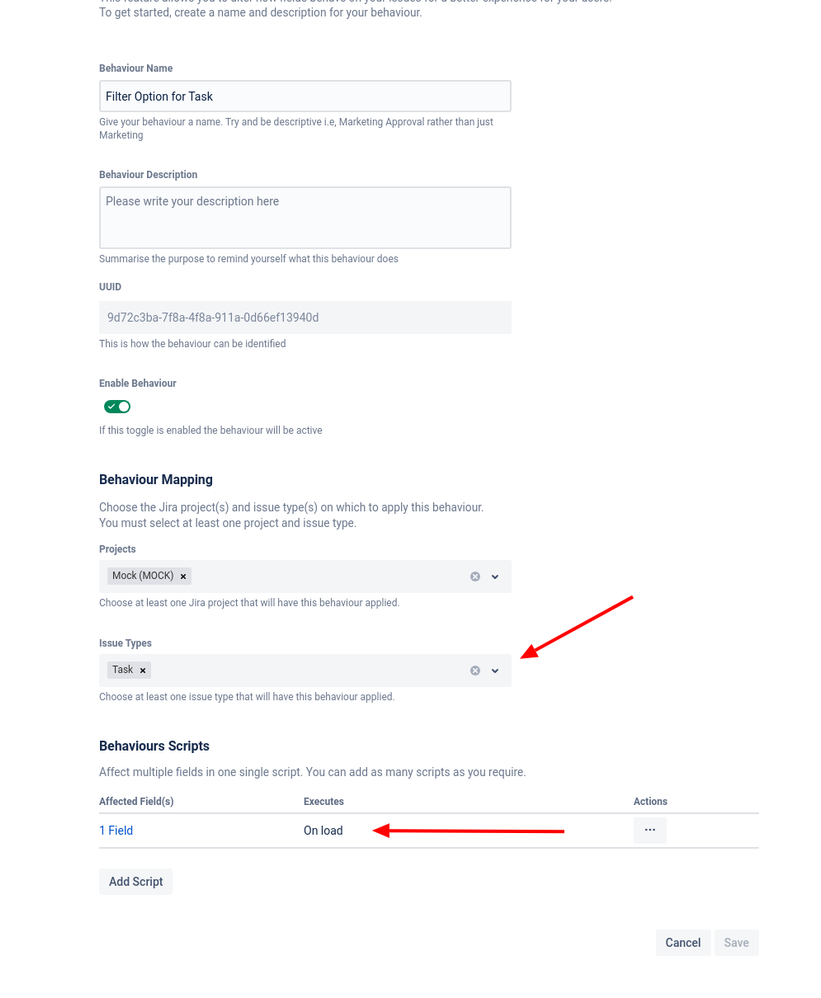

Next, create a Behaviour configuration and set it for a specific issue type.
In the screenshot below, the Behaviour is configured for the Task issue type.

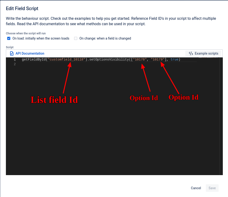

Next, add the script below to the Behaviour configuration:-
getFieldById("customfield_10118").setOptionsVisibility(["10178", "10179"], true)
Below is a screenshot of the Behaviour configuration:-
So the custom field id used in the code above is for the single-select list. In this example, the field I'm using is called Sample List, and the values 10178 and 10179 and the IDs for the options, Option 1 and Option 2 from the Sample List.
Since you intend to add this filter for multiple Issue Types, you must create separate Behaviour configurations for each issue type.

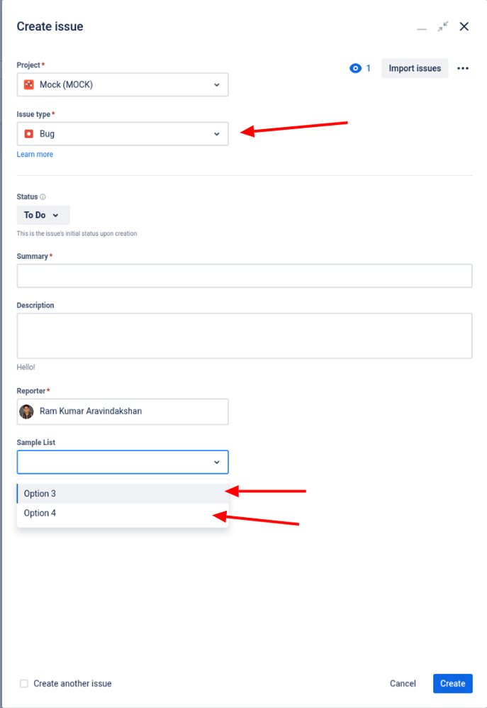

Below is a test screen of the filtered list option when the Task issue type is selected:-
I have created a similar configuration for the Bug issue type and changed the options to Option 3 and Option 4. Below is a screenshot for your reference:-

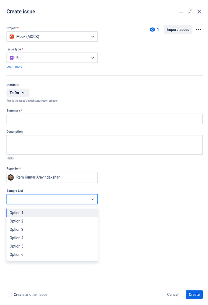

And for all other Issue Types where the filter is not added, all the options will be displayed as shown in the screenshots below:-
