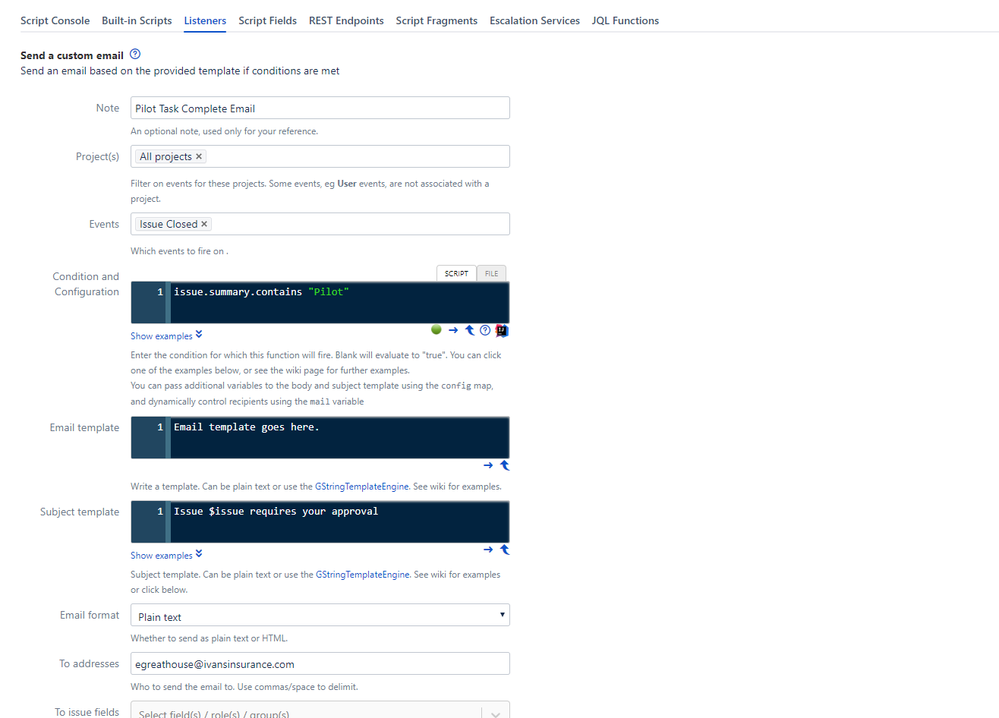

ScriptRunner_listeners_edit.PNGScriptRunner_Listeners.PNGHi,
I have three issue summaries:
1. Pilot
2. Test Pilot
3. PilotTest
I would like the appropriate groovy script condition that will return true for all three cases. I'm attempting to create a "Send Custom Email" Listener using Script Runner. I have tried:
1. issue.summary ==~ /Pilot/
2. issue.summary.contains "Pilot"
But this does not work. Any help would be greatly appreciated.
Mark Markov
July 31, 2018
Hello @Edward Greathouse
issue.summary.contains("Pilot")
Should work.
Edward Greathouse
July 31, 2018
That worked! Thank you.
