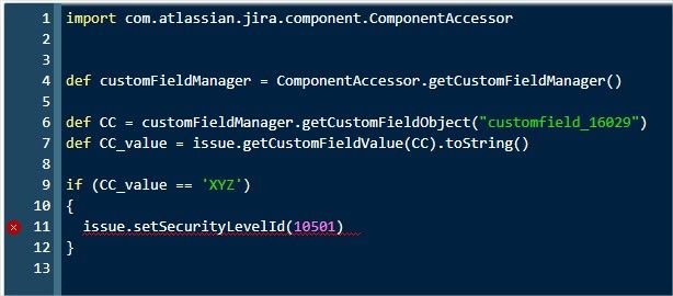

Can anybody help me?
I guess I'm commenting some silly mistake
I have more than 60 security level created (one for each cost center)
I'm trying to create a post-function script that will fill the security level according to the cost center informed.
But I can not understand why the issue.setSecurityLevelId (10501) gets highlighted saying "Can not find matching method"
def customFieldManager = ComponentAccessor.getCustomFieldManager()
def CC = customFieldManager.getCustomFieldObject("customfield_16029")
def CC_value = issue.getCustomFieldValue(CC).toString()
if (CC_value == 'XYZ')
issue.setSecurityLevelId(10501)

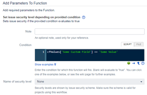

If you have Script Runner, what about doing in that way;
sorry for the delay to reply..
I can not do the way you indicated because the security level will be based on the cost center of the person who is opening the issue.
so I have to do some checks on the post-function to know what the correct cost center is.
if it were to do the form suggested, it would have to have several post-function validating whether or not it is in that cost center (we have 70 different cost center).
My code works, I was just curious why the red mark (as if it was wrong).
Ahh got it @Dante Labate. There is nothing wrong with your code.
The reason for red mark is; script doesn't recognize the issue so it doesn't find matching method for issue.setSecurityLevelId(). (but gets issue object in post-function as expected)
Ex; if you add the following line at the beginning, you will not see that error. But do not of course, it just for one example issue :)
def issue = ComponentAccessor.getIssueManager().getIssueObject("ABC-1");
Ahhh .. that makes perfect sense ..
Thank you for answering my question.
