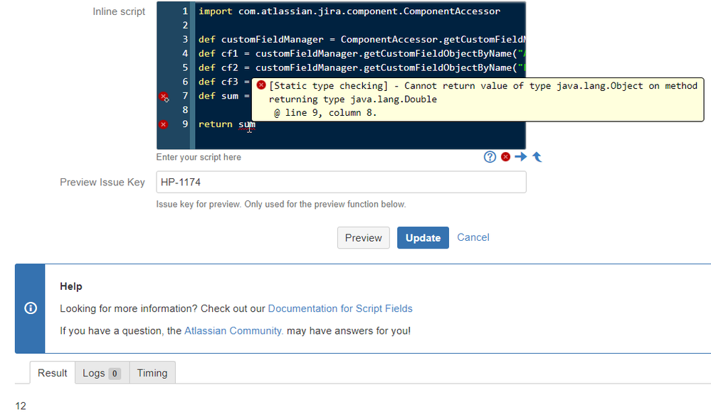

Hi Daniel,
Does this have to be placed into the "Inline Script" section. If so, i'm seeing an error on the addition operator "+".
Jeff
The error suggests one or more of the values coming back from the fields is not a number.

Jeffrey!
Those errors are static type checking. You can disregard them unless they give problems in execution time.
Please just save your script as is. It should work.

I was able to finally receive a return value. The only issue is the value cf1 is only being returned and I'm receiving error now under
The values I have under this issue is 12 + 13 + 14
return sum I receive just the 12.
What I did to resolve this issue was since it didn't like summation operator define as
define sum = issue.getCustomFieldValue(cf1)?:0 + issue.getCustomFieldValue(cf2)?:0 + issue.getCustomFieldValue(cf3)?:0
I used the summation operation in the return clause and also returned the value as a double since it was complaining about that too and came up with this.
