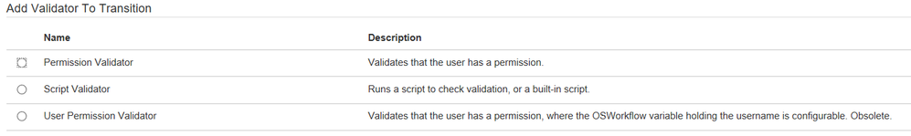

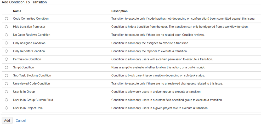

IÂ tried to use validators or conditions in workflow but I don't find a solution. (I attach the possibility of condition and transition)

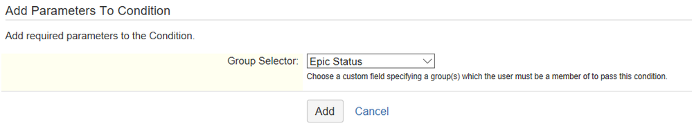

I tried to add a Group Custom Field (but it is possible to select: checkbox, select list or epic status) or a User picker (multiple users but I need each time to select the users and I don't know how to integrate this in the permission of transition) but I don't know how to use this...

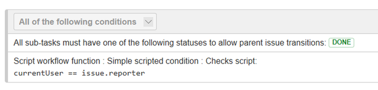

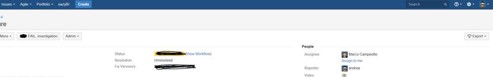

I tried this simple scripted
- Reporter is current user
currentUser == issue.reporter
but it doesn't work! I don't understand why but it doesn't work...

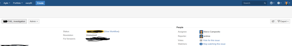

the result is this if I am login with Marco and Andrea user
It is visible only the FAIL button even if Andrea is the Reporter of issue and I am login with his profile...
I think there is a "problem" with the "currentUser" instruction...
I tried your condition in "positive" and "negative"
currentUser == issue.assignee : nobody see the button
currentUser != issue.assignee : all users with transition issues permission see the button

If I use the script:
there is the screenshot above with Reporter = Andrea (black hair avatar) and login with Marco (brown hair avatar) and Andrea.... Andrea doesn't see the PASS button
-> doesn't work
@Thomas SchlegelI know... it is so wired... and I don't understand why...

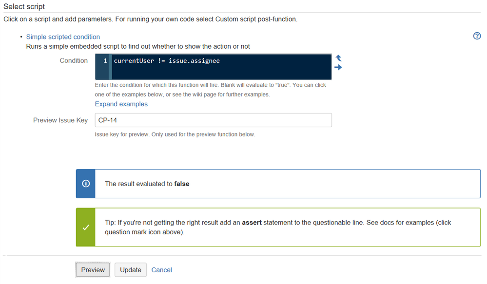

@Thomas SchlegelI have "news"...
I tried to use the Preview using an Issue key and the result is thisit
It is really wired!
when I tried this I am login with Marco account and the Issue CP-14 is the same of screenshot above (Assignee Marco - Reporter Andrea)
the condition if I press Preview is correct! (I am login with Marco, so the currentUser is not different of issue.assignee -> false, so the button should not visible) but when with user Marco I show the CP-14 I have the possibility the PASS button and the Issue goes to the next status....
could you please check this JQL:
key = CP-14 and assignee = marco
i used the JQL:
key = CP-14 and assignee = macampe
because the username is macampe, not marco and the result is one issue (CP-14)... the JQL is correct
I tried only the JQL: assignee = macampe
and the result is only the 3 issues in all my 2 project, the result is correct
so I don't know why the simple scripted condition
in preview mode (using key CP-14 or the issues in the second JQL) works (the result is False because currentUser is macampe and the issue.assignee is macampe)
but if I view the issue with macampe user the button is visible and clickable...

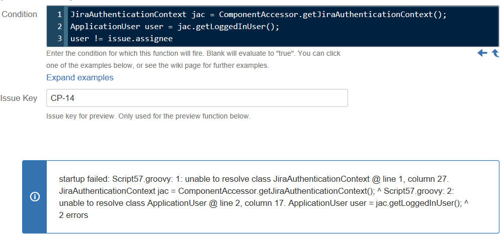

Have you tried getting the user with:
JiraAuthenticationContext jac = ComponentAccessor.getJiraAuthenticationContext();
ApplicationUser user = jac.getLoggedInUser();
The common error I have with users is when they have a different user_name and user_key! You can check if Marco is affected with a simple SQL query (if you can run it in your db):
SELECT * FROM app_user WHEN lower_user_name <> user_key;
It's frequent, especially when renaming a user!

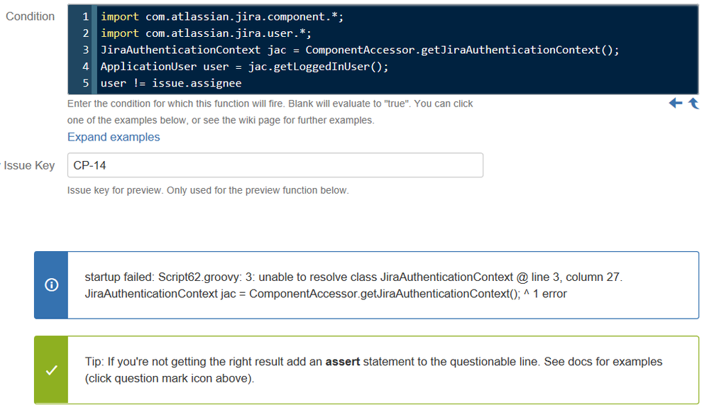

Hi @Thomas Schlegel and @miikhy, htank you for your time.
I am a new member and I tried in the simple scripted condition only to copy and paste:
from
to
probably it is necessary to import some classes, but I don't know which classes
So I tried with these import (I searched on Altassian JIRA 6.4.14 API and I found these)
(If I used component.ComponentAccessor and user.ApplicationUsers the error were the same of without import)
I tried to extend the import to com.atlassian.jira.*; but the result was the same.
could you help me please?
Hey,
You're missing the com.atlassian.jira.security.JiraAuthenticationContext import here, whenever grrovy suggest a class cannot be resolved, you should go in the javadoc and look for its name ;-)
Hope this helps!
Cheers
Hi @miikhy, right... sorry I didn't read with attention the error message.
but I have an other error message, now the script is this
import com.atlassian.jira.*;
import com.atlassian.jira.user.*;
import com.atlassian.jira.security.JiraAuthenticationContext;
user.getUsername() != issue.assignee
the message is below and I don't know what to do.
