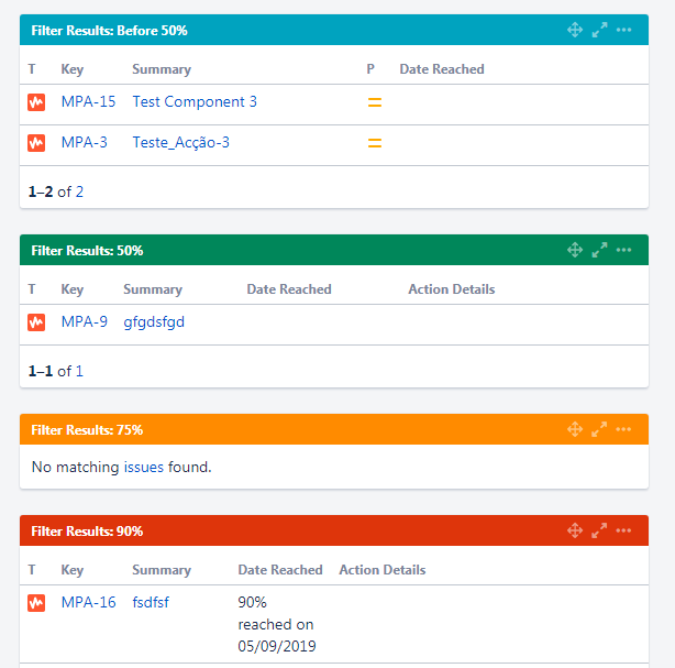

Capture1.PNGMy question is, is there a way of, let's say notify a user, each time an issue gets in these filters, not a subscription (that notifies all the issues in the filter everyday). I wanna get notified only once, each time a issue change its status, without needing an update (only the date changes).
