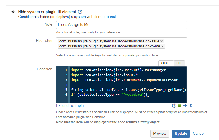

Trying to hide the 'Assign to me' link and button on an issue type called 'Procedure'. It's not working using a variety of codes. Currently trying:
Any thoughts much appreciated.

Your code does not return a value. It must return true if you want to display these items and false, if you do not want to the items to be displayed:
if (selectedIssueType == "Procedure") {
return false;
return true;
taxgaming May 10, 2018
Thanks. Working now. For some reason I thought the function evaluated itself.
I've also realised the 'Assign to me' doesn't remove the blue hyperlink. Shame.
