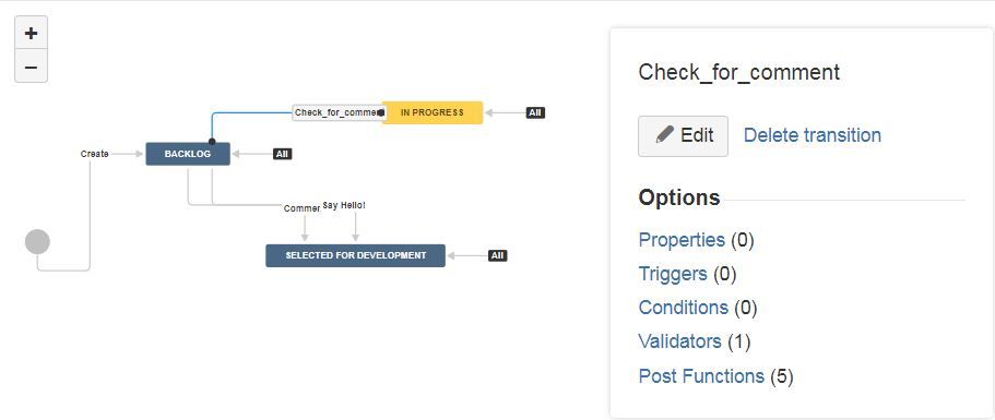

Junianto Kosasih
August 11, 2017
Hi Justin,
Thank you for the reply. I have followed the instruction and put the transition as part of the validator.
If you see my workflow below, the 'check_for_comment' transition from 'BACKLOG' to 'IN PROGRESS', I have validator set. I could see from your answer that it works for me. I am trying to figure out what do I miss. Could you please give me some pointers/information?
Thank you.
