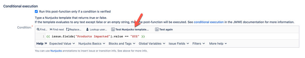

I'm configuring a "create issue" post function with a "conditional execution" added so that the Create Issue should only run if/when custom field (a Single Select List) is set to "XYZ"
I've tried
{{ issue.fields['Products Impacted'].value == "XYZ" }} but this is always returning false no matter whether null, set to XYZ or set to something else
Thanks for the help!

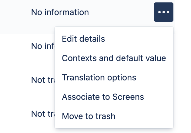

  • If you still get false for all the scenarios, navigate to Settings > Issues > Custom Fields > Search for 'Products Impacted' >  Click on .. against it and click 'contexts & default value > check for XYZ value > Edit it and check if you have any spaces before or after XYZ. If any space exists please remove the spaces & save. Try the scenario.

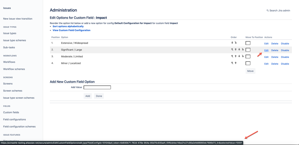

  • Please note that you will be able to see option id once you click on Edit against select option. Please refer below screenshot.
