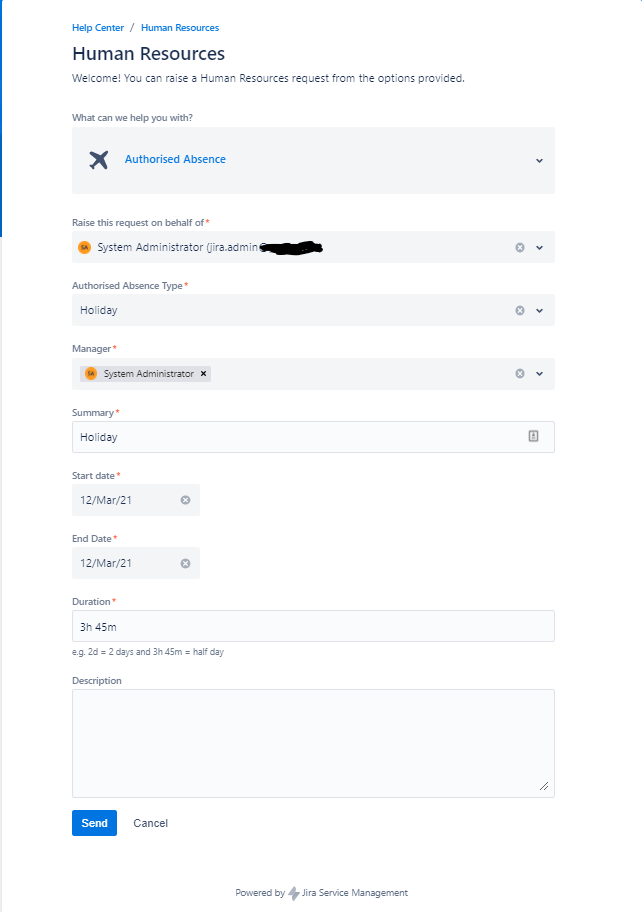

On the request form, I need the employee to fill out a duration field for how much time off they'd like, which could be 1d, 1h or even 30m etc, so I need them to specify.

The problem is I have to monitor each request to make sure they put their duration in the correct format that Jira likes. e.g. 1w 5d 2h 30m with a space separating each time unit. If they don't put a space Jira doesn't like it.

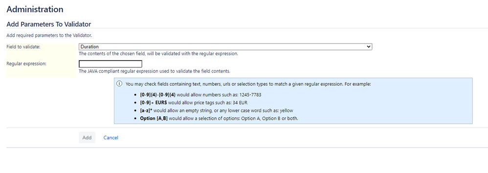

So I want to add a validator on the "Create" transition of the workflow which uses a regex to check for the correct format, I think I'm almost there with the below regex but if anyone has done this before or has any ideas then please let me know!

This is the final version I have implemented as a workflow validator on the create transition (just ensured letters were lowercase):
^([0-9]+([.][0-9]+)?[wdhm])([ ][0-9]+([.][0-9]+)?[wdhm])*$
