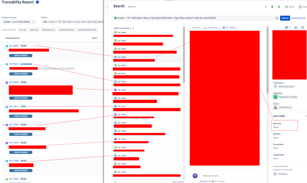

X-ray is generating a traceability report with issues (what I defined as coverable issue types) with the Epic Link Empty, so the traceability report is not completed because most of the issues are missed.
I am using this JQL filter: project = "HF" AND type in (Task, Story) AND labels = hw-video-creation ORDER BY created DESC
Adding the "Epic Link" in (...) (or parent link) to the JQL filter doesn't work.

Hereby the screenshot:
Left side only issue types with 'Epic link' empty (I want to see all the issues). Right side, issue types using the same JQL Jira filter that it is used for traceability report.

can you give a concrete example of an issue that appears on the issue search page that doesn't appear on the Traceability report?

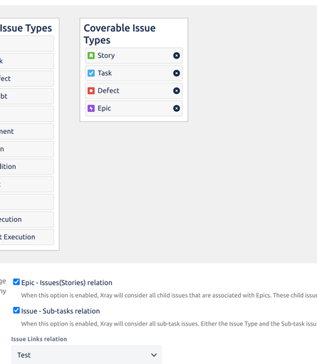

Can you also show your settings in terms of Test Coverage, what issue types you have defined as coverable issue types?
Please note that the order of the issues isn't guaranteed on the Traceability Report.

I have defined coverable issue types: cov_issue.png

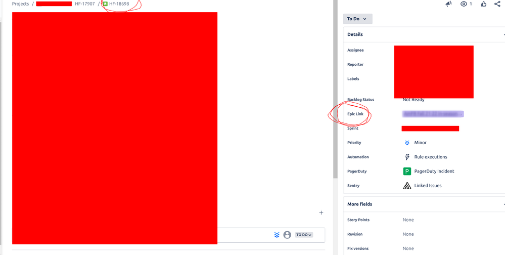

So I expect all the coverable issue types in the traceability report, but the issue HF-18698 (you can see it first screenshot I sent you) doesn't appear (and i have checked the traceability report and issue types with "Epic Link" not empty, are not appearing):cov_issue_1.png

That story should appear on the Traceability Report but under the respective Epic, so can please search for the corresponding Epic on the traceability report and you should see a ">" before it; if you press it will expand and show the Story issues underneath it.
