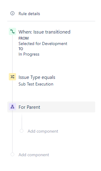

from my point of view this could through "issue transition" trigger, condition "issue type = Sub TestExecution".
It would be helpful if the execution is created as a Sub-TestExecution in the story. This will help create a parent branch and transition the story to another status (see screenshot).

Da gibt es die Möglichkeit, mit Links zu arbeiten. Setzt jedoch voraus, dass die TestExecutions richtig und immer gleich in den Stories verlinkt werden. Auf linkedIssues kann die automation rule reagieren.
XRAY-interne values (zB passed oder failed) können mittels der internen automation oder JQL nicht abgefangen werden. Jedoch hat ja auch das Issue "TestExecution" die ganz normalen status wie alle Jira issues. Den Status der einzelnen Testruns in der Testexecution muss ja auch von jemandem gesetzt werden. Im Zuge dessen kann der Status des issues "TestExecution" dann auch gesetzt werden, woraufhin eine automation rule dann schon reagieren kann.

An automation rule can‘t be triggered by a test RUN status change (as test runs are not native jira issues). The suggested solution was to work with linked issues - created test executions are linked (with your prefered link type) to the story. As the test runs need are operated by testers and need to be done the test execution should be set to done when all test runs were done.
Differently to test RUNs a test EXECUTION is a native jira issue and therefore an automation rule could be triggered by its transition.
my suggested rule would look like:
