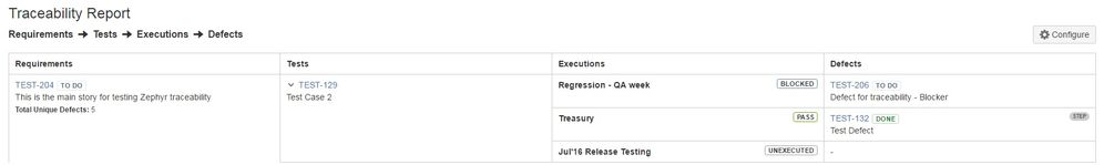

While pulling Traceability Report, why are all executions listed when the search is for a version, In the image below the 3 executionslisted are from 3 different versions and all are listed when searched for one Version and Story.ZephyrIssue.jpeg

I think I was not clear enough in the first post,
Given that : -
- The Test Cycle is associated to a Version,
- Story is associated to a version [from your response Fix Version]
Assumption:  Test Case's association to a version should not matter
Now to pull traceability , I select a version and a Story;
From the listed stories I select one and generate traceability from [Requirements --> Tests --> Executions --> Defects]
In the result, Test Cycles from Versions other than the one selected are also displayed.
The scenario is that the Test Case(s) attached to the story are regression cases and were executed in the past for a diffferent story; but pulling a report now should bring up only Test Cycles for selected version.
Please lete me know if this explains the issue.

Did this issue get fixed as i am having the same issue with the report. I have all tests that i want to report on with the fix version applied. However when i generate the report it shows the tests that have been tested in previous version, the previous tests do not have the fix version they have the affected version applied but are still being pulled through. Any ideas on how i can fix this. It makes the tractability quite confusing.

Any progress on this issue. Without this, its impossible to include regression and retest as part of traceability
