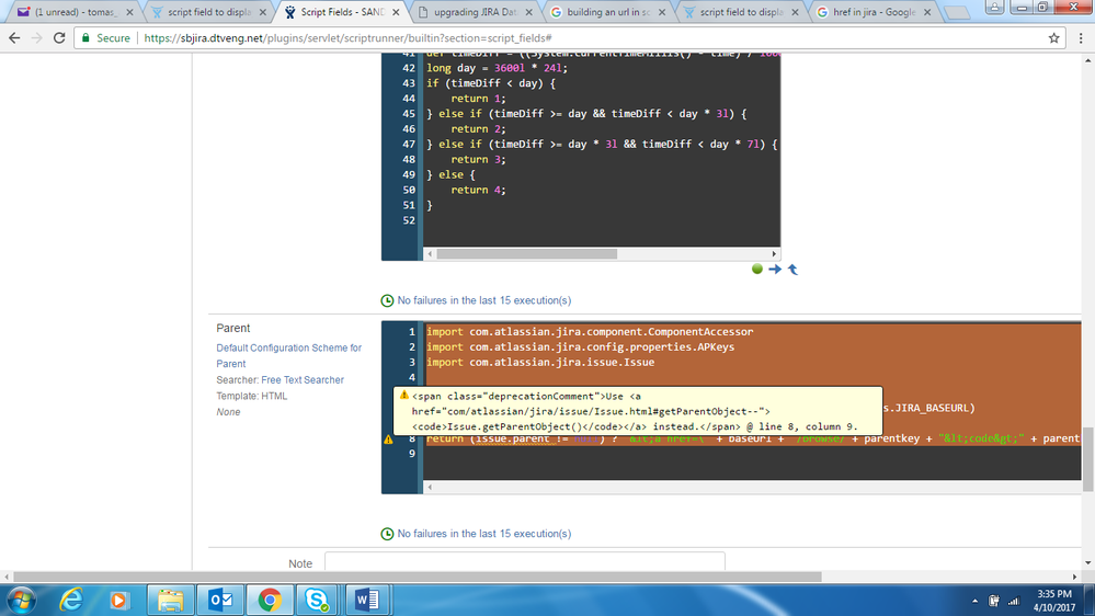

Hi Nic...thank you for your answer.
What I want is to display it as a linkable item, so it is option 2. I had set the template to html before asking the question here and it does not do it.
The pic above is the message I am getting when editing the script. It is suggesting a specific format. I think I am missing the closing " or something else. I am not sure about <code> </code> either
Sorry, I skimmed the html as it looked like you had copied and pasted a working script and set the template incorrectly.
You are right about the output being slightly wrong. You're missing a closing " and yes, you can lose the <code> bit. i.e.
<a href="https://sbjira.dtveng.net/browse/KANBAN-15<code>KANBAN-15</code></a>
should be
<a href="https://sbjira.dtveng.net/browse/KANBAN-15">KANBAN-15</a>
I think you need :
"<a href=\""+ baseUrl + "/browse/"+ parentkey + "">" + parentkey + "</a>" ;
That should get you closer, but please check it or try it carefully, as I struggle with escaping characters correctly.
