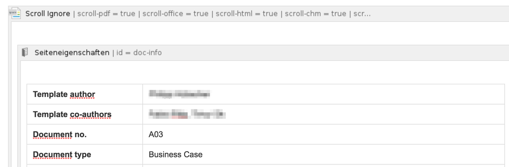

I attached a screenshot of how I built the page with scroll-ignore and page-property macro.

Addendum: When I configure both macros the other way around (scroll-ignore within page-properties) I get a blank page in the PDF-Scroll-Export after the table of content.
