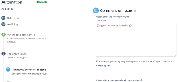

I think we'd like to be able to create automation rule, that then the issue is commented, added this comment to all linked issue.
We have been surrised not to have found the option already in automatiom...
Thanks for any advise

You can reach this result through a rule with the structure below:
1) TRIGGER - "Issue commented"
2) BRANCH - "For linked issues"
3) ACTION - "Comment on issue", using the code {{triggerIssue.comments.last.body}} and enabling the "Prevent duplicates by only adding this comment once to a particular issue" - this last is important to avoid looping issues.
Your rule would look like the following:
I hope it helps!
