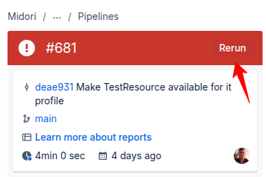

I looked up a failed build, and found this one (691) from 4 days ago, with the "Rerun" button available:
When I clicked "Rerun", it started a new build (693).
I also think there may be a confusion of terms on my part. I think in this case only one step failed and it was rerun, rather than the whole pipeline (which would produce a new integer ID).
When a failed setup is rerun on its own, this dropdown presents itself.
The dropdown should show you the list of successful/failed runs for that particular build, and their associated logs when accessed.
