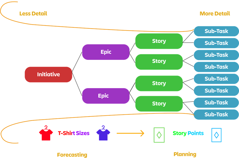

T shirt Size Currency/Metric Conversion per team - ‘How can you size large pieces of work before you break them down?’ (Optional but strongly recommended)
  • T Shirt sizes form the basis of your high level effort estimates. They allow Teams to roughly size and plan before breaking large buckets of work Into smaller manageable pieces.
  • The T-Shirt sizes (although rough and prone to more error than smaller sized estimates) can be converted in to an effort metric. I.e. If we are using Points, a Large could be lets say 200 points, a Medium 100 and so on. These estimates can be refactored as you learn the true nature of what your original T-Shirt estimates end up being once delivered.
Agree on a unified ticket Architecture - ‘How are you all defining and tracking your work?’ (Optional but strongly recommended)
  • Having a ticket work Architecture allows all teams to agree on how to split up work items. i.e. You could have Epics as your largest pieces of work and Story’s as your smallest. Defining what these work items are and how they are used, estimated, allocated and tracked will make the whole process run a lot smoother!
    • See below for how you can break down a problem for a Team into its constituent parts

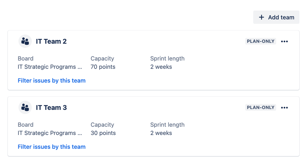

Team Capacity
  • Set your Team capacity against your teams in the Team module. From here you can assign a Team to a board where it will read Sprints from that board to assign to your team

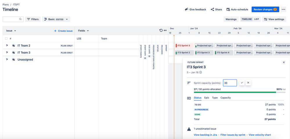

Forecasting
  • Once you have Teams with capacity and work assigned to those teams by using the ‘Team’ field and then assign dates or Sprints to that work then AR will do the rest and begin to show your Sprints filling up like magic!
  • AR will even forecast Sprints when Sprints are not available in your backlog. To do this again simply ensure a Team value is applied and that the work items have dates.
  • Changing Sprint Capacity
    • Holiday period coming up? A team mate on Vacation? Worry not as you can also change future sprint capacity loads on the fly to reflect this

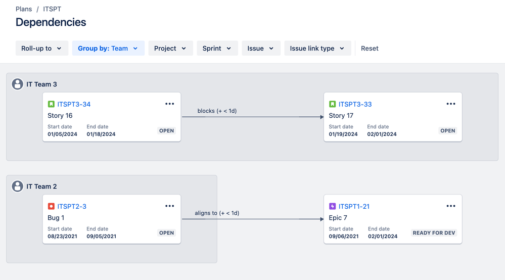

  • Dependency tracking
    • An In-built Dependency tracker will help you identify Bottle-necks and also highlight the critical path. This can be done for all teams or a subset of teams over any duration of time.
