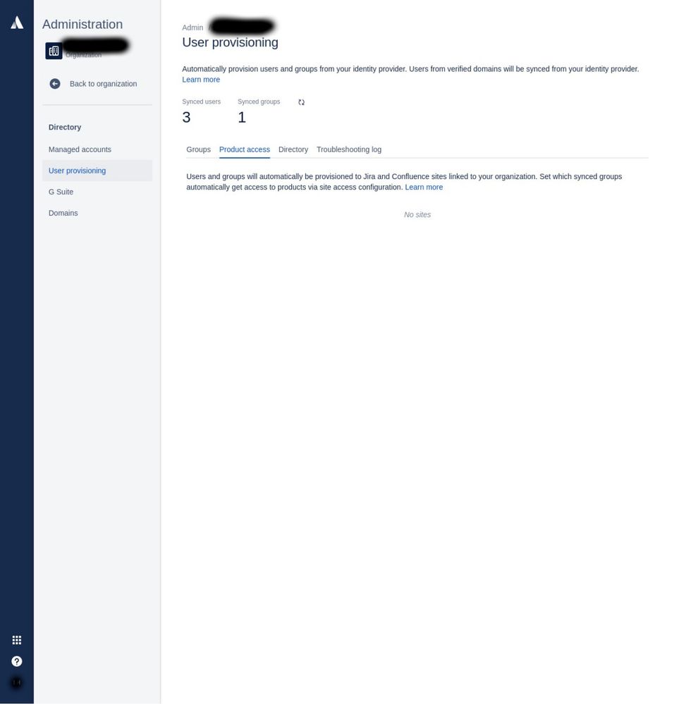

I have set up user provisioning between Azure AD and Atlassian Cloud, and I am able to see users, as well as groups in atlassian access, that have been provisioned. However, I cannot find those groups/ users under "manage users" or "manage groups" within the admin panel. Since I read that this issue may be linked to adding my existing sites to my organization, I have tried that, but under user provisioning --> product access I don't get the option to add sites. Is there anything I am missing here?

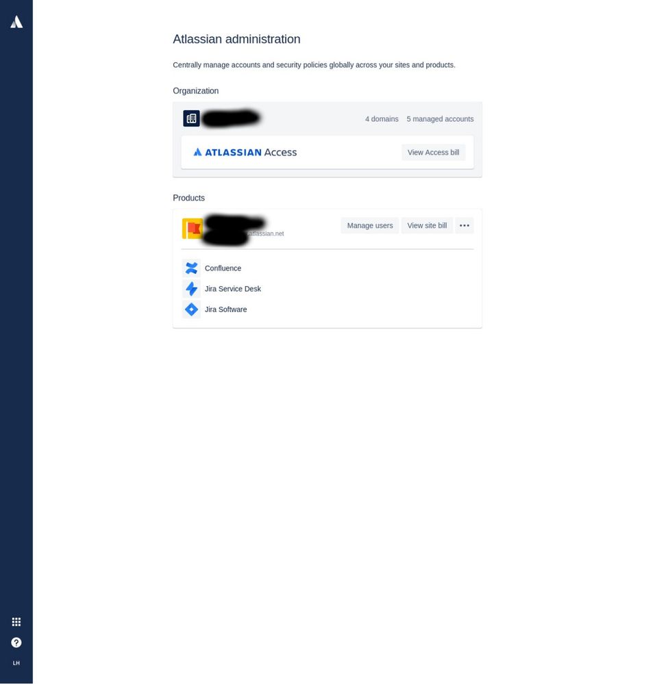

Since I wasn't able to attach screenshots just now, I have attached a screenshot of the respective admin site to this comment:

What's probably happened here is that your Jira/Confluence site was automatically added to a different organization than the one where you've verified your domain and set up user provisioning. Assuming you're an administrator of both organizations, go to admin.atlassian.com. You should see multiple organization "containers". Likely one will show "Atlassian Access" and refer to a number of managed accounts, and the other one will show your Jira and Confluence site.
Go to the one with your site, and follow these instructions to transfer it to the organization where you've set up user provisioning: https://confluence.atlassian.com/cloud/transfer-products-to-another-organization-967318518.html

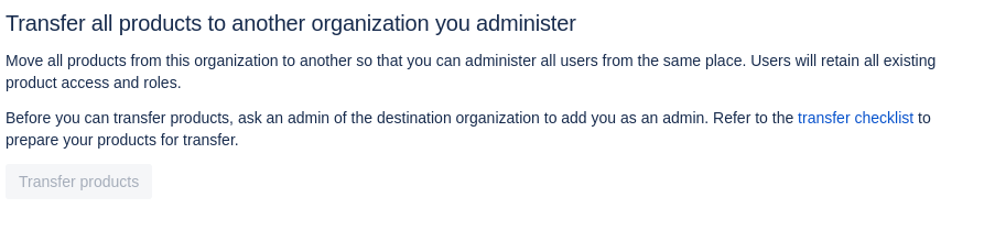

So this is how my admin Panel looks like, would that confirm your theory? The thing is that I don't see the option of transferring my products anywhere, it's just grayed out. Any idea's?

So it looks like what's happening here is the site with your Confluence, Jira Software, and Jira Service Desk is part of a separate organization than the one where you've verified your domain and set up user provisioning, but you are not an admin of that organization.
I would recommend checking with other folks at your company to see if one of them is an admin for the organization and can add you first, and then for that other organization the "Transfer products" button should be available. If you are still struggling to figure it out, I would recommend contacting our support team.

Thank you Dave, that was exactly the problem. I am now the administrator of the original organisation and have added atlassian access to it.
