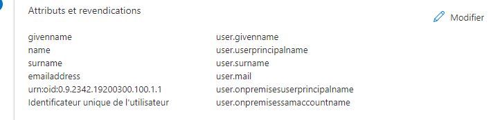

I want to use UPN like a login I think is here but I don't find how I can do.
Please help
Thx

Short answer - DO NOT. Nothing else but email will work.
"name" attribute (on the left) is not used by Cloud at all
"urn:oid:0.9.2342.19200300.100.1.1" won't be used by Cloud
the "Unique User Identifier" absolutely MUST be set to user.mail – Cloud uses the email address for everything (whether you want it or not)
Please note, this doesn't prevent you from actually logging into Azure AD with whatever you want – the email, the UPN or the username...

This is not accurate. Although you emphasized that everyone should use user.mail, if you have your Azure configured in a way that this attribute is empty in users profiles, it won't work.
Additionally, the instructions from Microsoft mention 2 different scenarios (step 14): if you have MS 365, they recommend you configure this Unique User Id to user.mail, but if you don't have MS 365, then this attribute is not used in Azure, so they recommend you use UPN.
See here the official documentation with instructions to set up SAML SSO with Azure https://docs.microsoft.com/en-us/azure/active-directory/saas-apps/atlassian-cloud-tutorial.
There is no right or wrong, it all depends on how each company's Azure is configured.
To respond @Vincent Arancio , if you have the UPN attribute configure with a valid email address, then yes, you can change the Unique User Identifier (or Identificateur unique del utilisateur) to be UPN.

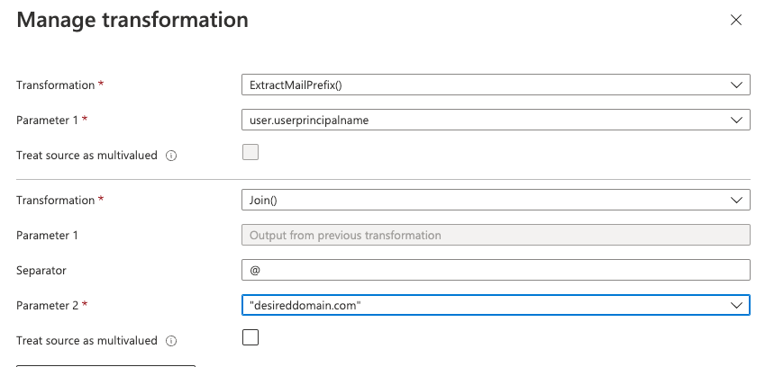

One remedy for Orgs with users carrying mismatching UPN and email domain may be using transformation and expression mappings for provisioning and SAML claims.  If we can align provisioning with SAML claim expressions/transformations, it may work?
For instance, SSO claim transformation mapping:
Thoughts?  Any experience with this?

So in the case where AAD UPN and primary email domains do not match, adjusting the provisioning mail attribute mapping like so should fix the issue?
Mail mapping:
**EDIT: I don't suggest people try this, particularly if you have AAD B2B users.  Forcing the UPN isn't a solution for guests.  See a lower post for my solution.

I appreciate your engagement Ed - thank you.  My scenario may be a little different, where having existing provisioned users and groups change their primary email address to use a different domain than the managed domain in Atlassian cloud.  This causes affected users to fall out of scope for the managed domain, disappearing from the Atlassian user list, and out of provisioned groups.
Some instructions
  • Do not directly map UPN to mails[type eq "work"].value - especially if you have B2B provisioned users.
  • If the domain used in user UPN has changed from the managed domain in Atlassian config, this method will not work, you will have to reconfigure SAML and SSO.
  • This method also works in cases where UPN prefix is different than email address prefix.
  • I suggest you disable automatic provisioning and verify with a test user.
Change the user provisioning Mappings for the Atlassian Cloud Enterprise App
AAD attribute: mail
Atlassian Cloud attribute: emails[type eq "work"].value
  1. Change mapping type from Direct to Expression
  2. Replace mail attribute email domain to match UPN domain
  3. emailprimarydomain.com - change to your primary email domain
  4. upndomain.com - change to the UPN domain
  • Save and test
