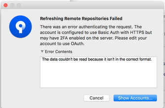

If I try to Refresh Remote I get these errors:

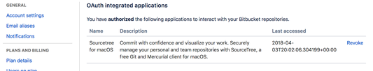

However, if I check, my account indicates I am using Oauth:
