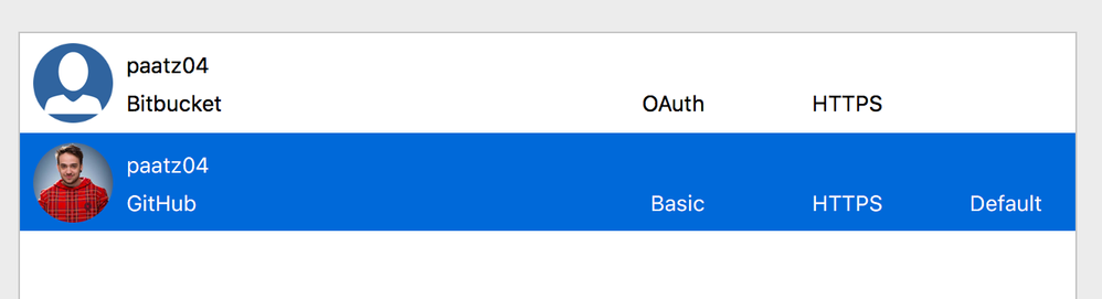

I just tried to change to basic but no luck. I get this error:
2018-01-31 23:34:24.085 git-credential-sourcetree[31641:15415041] Error generating password due to missing uuid. Please report this to Atlassian.
Also there is nothing in the keychain for github.
