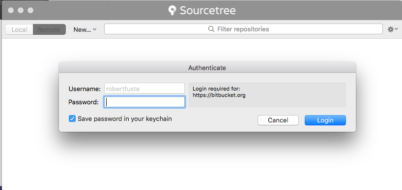

The problem begins when I'm viewing my remote repository list and click on "clone" for one of them. It brings up a login screen, and no matter how many times I try to login, it keeps giving me either an error message, or bringing up the login page again.
In this scenario, my login is grayed out (pre-filled) with my username, which is different than my email address.

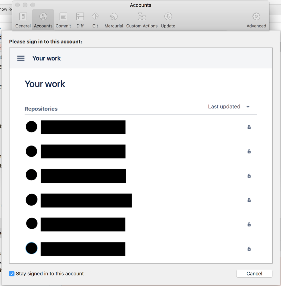

I experience same problem when using a Google account to login to bitbucket. when using suggested https method , source tree keep asking password and I have to save the generated app password and keep login again and again which is not good. I prefer using Oauth with SSH so all the keys are saved. the problem is when I login with my google account it redirect to repository view and not close after successful login , and only option is to click cancel.
The work around I found that works is , remove the account from source tree , then close source tree. go to your account on bitbucket settings -> oauth under access management , and choose revoke access to source tree. After that open source tree and add account , log in with your email and google authentication , you should see the screen of asking you to grant access for source tree to bitbucket account. if you see that screen, after you grant the login popup should close and you get access.
The bug I think is if at this stage it does not show the grant access screen (since you already granted) it will go to the repository list view and source tree does not see this authentication as complete.

Hi everyone, I've attempted @Yosi Oren's fix, however I seem to be stuck after the log-in page. There must be some sort of confirmation button that's missing here, as I can only press cancel. Any thoughts?
Check out last paragraph of my answer. If you list of repositories then you have experienced what I think is a bug. You have to restart the process from the top. Make sure to remove access already granted so the grant permission screen will appear next time you login.

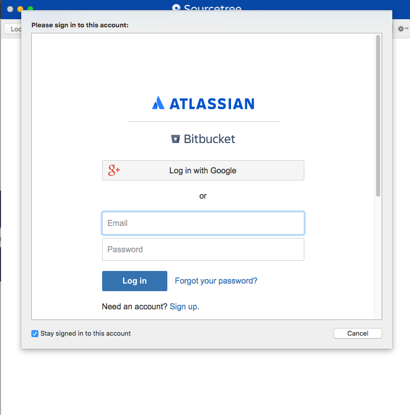

1. I open up SourceTree, and I'm taken to the "Local" repository tab, which is empty at this point. When I click on the "Remote" tab next to it, I see this login screen. You'll notice the grayed-out username of "robertfuste", even though I always sign in to bitbucket.org with my email address instead.
Nonetheless, I enter my password, which I confirmed before works on bitbucket.org.

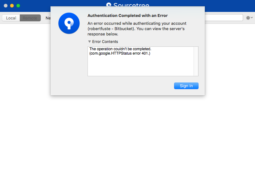

2. After attempting the first sign-in, I get the following error:

4. I enter my credentials (this time using my email address), and this is the error message I get:
5. When I click on the "Sign In" button, I get the login screen again, and now I'm stuck in a loop:
