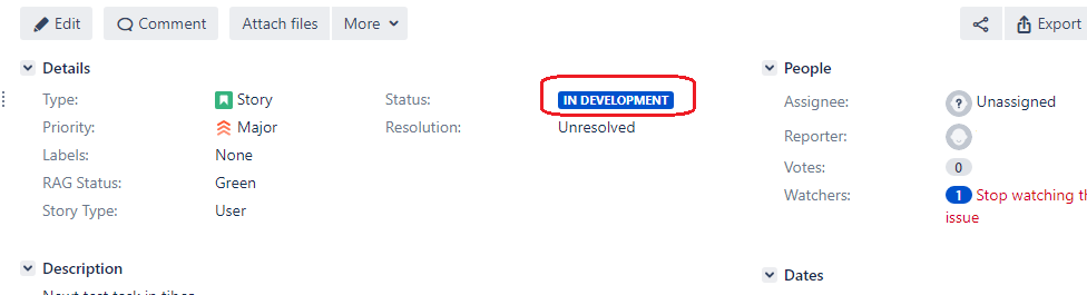

remote: In order to commit, your JIRA must be "In Development".
remote:
I check Jira again,
Its status is in development, pls see attached picture..
thank
You have to check how your hook is setup in Bitbucket, it might be that it also triggers on commit comments, so you would have to make sure any issues mentioned in the comment are in the correct status.
