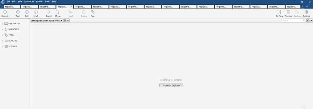

Leo Steiner
June 1, 2017
+1. We're also being forced to move to a different GIT client.
We upgraded a few weeks ago, tried living without the sidebar but finding it a big step backwards in productivity. Particularly as our 100+ repos all share a common prefix...
Please consider bringing back the sidebar or consider alternatives for working with large, organized sets of repositories.source-tree-tabs.png

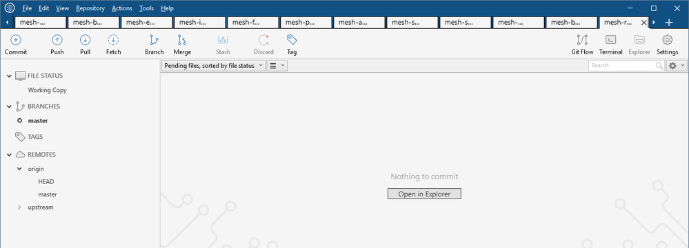

Michael Benz
May 31, 2017
At the moment I can fit up to 10 repositories tops in the new tabbed UI in 2.0.20.1. Like so many others before it is hard to see which tab you are actually on. (waiting to see the improvements in v2.1)
Ricardo Salcedo May 30, 2017
Just wanted to add a screenshot of what people are talking about when they say all projects beginning with the same prefix look identical :-D
