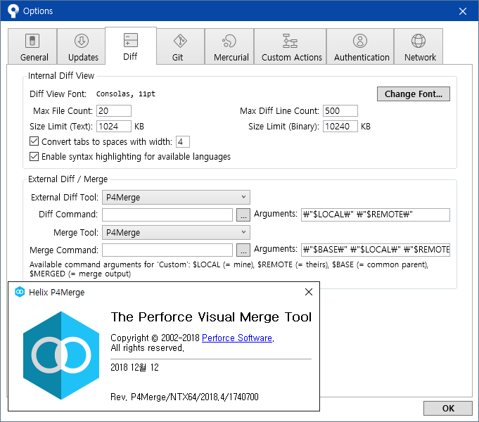

I have downloaded P4Merge and SourceTree 3.0.17.2659 on my 64-bit Windows 10 laptop.
The W looking thing is a WON currency. It is shown like this because I'm using a Korean-based laptop.

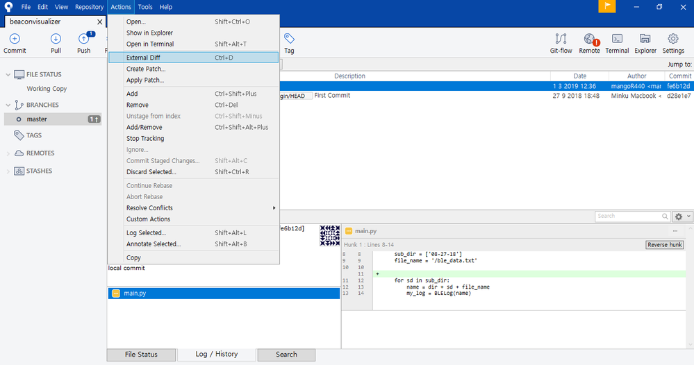

However, after I click the "external diff", nothing happened.
How can I launch P4Merge and compare files?

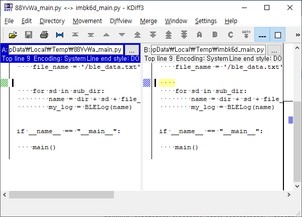

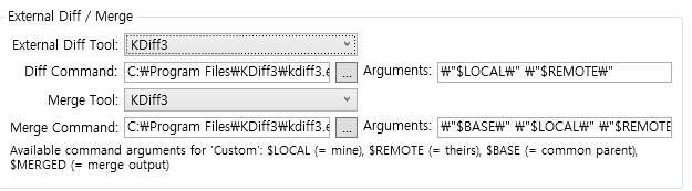

I installed the KDiff3 64-bit. This works when I press Ctrl+D.
Here's what I found. My Scenario:
Set the Diff tool to KDiff3. Then execute Ctrl+D and we will see it is working.
The KDiff3 really pops up fast that it didn't took a second. I'm testing this with a laptop that has i3 processor and SSD, BTW.

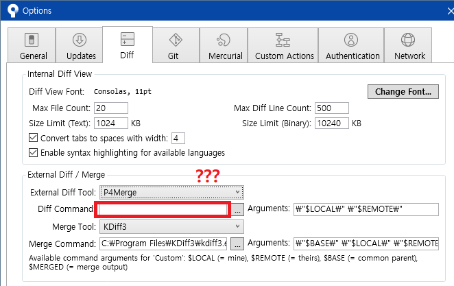

Now go back to settings and choose P4Merge.
Surprisingly, compared to the case when I choose KDiff3, if I choose P4Merge, it shows a blank on the Diff Command. Anyways, I pressed Okay.
NOW, when I press Ctrl+D, P4Merge pops up.
But it took like 3.5 seconds and I noticed the green progress bar. This bar doesn't always appear after pressing Ctrl+D.
So I thought everything was solved. However, after I turn off SourceTree and run it again, P4Merge doesn't show up when I press Ctrl+D.
In contrast, when I have a merge conflict, P4Merge does pop up when I try to solve the conflict with the external diff tool.
Can you guys try this as well and see if this is re-generatable on your side?

When you change diff/merge tool the path will initially be empty it gets set when you close the preferences, so that is OK.

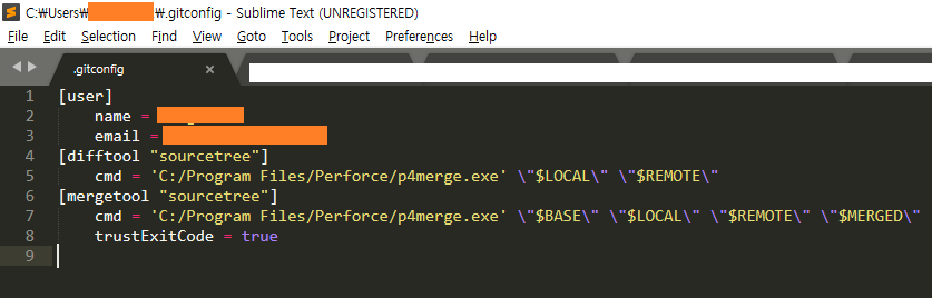

Hello! Could you post a part of your ".git" config file for me? You can find it under "C:\Users\USERNAME_HERE\.git"
Please post the part under "[difftool "sourcetree"]"
Thanks!
Hi, Mike.
cmd = 'C:/Program Files/Perforce/p4merge.exe' \"$LOCAL\" \"$REMOTE\"
[mergetool "sourcetree"]
cmd = 'C:/Program Files/Perforce/p4merge.exe' \"$BASE\" \"$LOCAL\" \"$REMOTE\" \"$MERGED\"
trustExitCode = true
When I opened it, it was shown like the above picture.
But still, P4Merge doesn't show up when I choose "External Diff".
