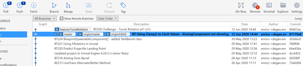

×I'm pretty new to git (so excuse my lack of branches and other bad practices), but I've been having a problem that I can't seem to fix. How can I move the commit BT228 Challenge - Turret Rotation pt1 (v1)
to be my latest commit? In other words, so that it appears on top?

One reason I was thinking this is acting strangely is that you usually rebase from one branch onto your master branch. So I’ve also tried putting my BT228 Challange...
commit onto a feature/TurretRotation
branch and then rebasing, but in that case the commit doesn’t even show up.
New branch
Rebasing using git rebase master
(no need for interactive stuff this time)
But that only moves the branch and not the commit:

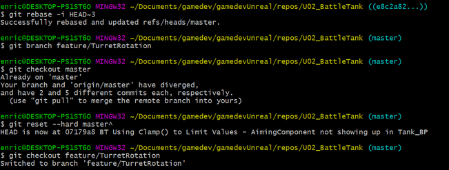

EDIT:
The solution I found was jumping off of Test #1 and then using these commands.

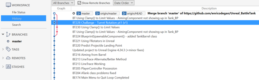

Then I forced pushed:
git push origin master --force
And this was the result:
