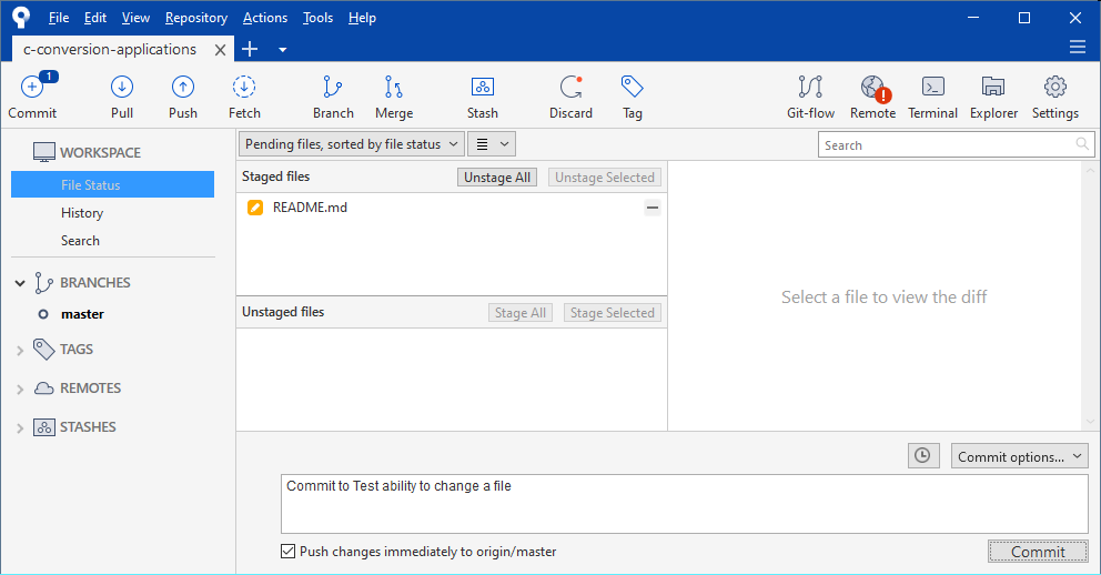

Francis V Bishop September 14, 2022
Its the commit that fails

Francis V Bishop September 16, 2022
This seems to have resolved my issue
Had to change from OAuth to Basic and re generate a new app password
a bit tricky since the account is a Managed Account and the location of the spot to regenerate the basic password had to be found
https://bitbucket.org/account/settings/ssh-keys/
But after testing a clone and then a commit I got it working

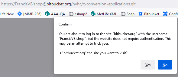

see attempt at fixing this

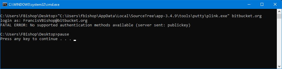

Thanks the log file also shows an issue with the RSA key of the server
