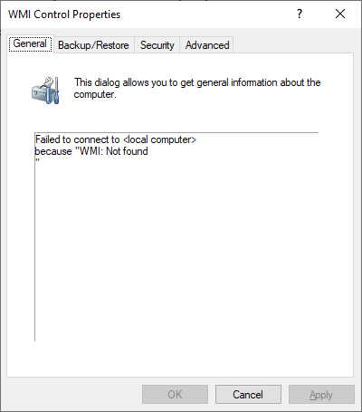

Hello! Looks like the WMI service has something wrong with it. Try following this thread and see if that solves the issue.
Hi Mike thanks for the reply. I've updated .NET from 15.9.12 to 15.9.15 and re-tried installing but splash screen still hangs and same errors in Event Viewer.
There is no 'Bugsplat' crash report but Event Viewer had a link to a 'Report.wer' file - I'll post that in a separate reply.
The WMI Control is listed as 'Not found'.
I tried running winmgmt /verifyrepository but just came back with similar:
C:\windows\system32>winmgmt /verifyrepository
WMI repository verification failed
Error code: 0x80041002
Facility: WMI
Description: Not found
Not sure where to go with this as the instructions in the other link are for an 'inconsistent' repository rather than a 'not found' repository.

Seems my previous reply went missing so I've reposted below:
I updated .NET from 15.9.12 to 15.9.15 (VS 2017) and tried reinstalling SourceTree but made no difference ie splash screen still hanging and same errors in Event Viewer.
There was no 'Bugsplat' dialogue but there was a link to a file called report.wer in the Event Viewer which I've posted above.
I've checked WMI and it is listed as 'not found':
Getting a similar response when I do a winmgmt /verifyrepository:

Not sure where to go with this as the link you gave me was to resolve an 'inconsistent' repository whereas mine is 'not found'?

Ok thanks Earl. I could really do with some answers though. Source Tree has been down since Friday and is integral to our Build/Release processes. Frankly it is quite alarming that a regular Windows 10 update has just wiped out SourceTree and nobody seems to be able to provide me any answers or resolutions.
The WMI service has some issue, which might be related to the update. You'll need to repair the WMI service -- a guide on how to do that can be found here
Thanks Mike.
Tip 1 - winmgmt /salvagerepository didn't work - it just came back with the same "Not Found" Description
Tip 2 - I had a look at the registry change but frankly making registry changes that I don't fully understand makes me rather nervous.
Tip 3 - The link to the WMI Fixer Tool didn't work.
Can you recommend any other WMI Fixer Tools? I have neither the the time or inclination to mess around with manual registry changes.
