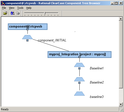

I would really like an option to see the fork visually even if there is no real divergence. It would be so much easier to understand what is going on. I know that the graph could expand quite a bit to the right sometimes with this option turned on but if you do not like it you could just turn it off. Please search for "clearcase version tree" in the Google images search and see the most intuitive graph view of all version control system. Thanks.

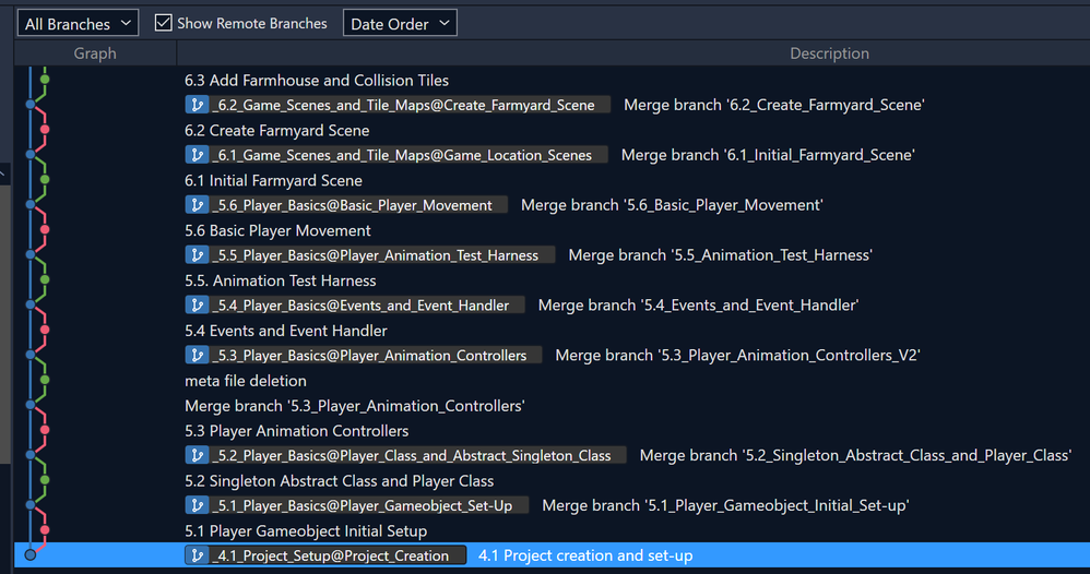

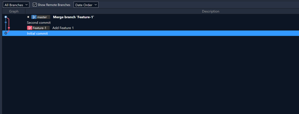

Found this topic, after searching for a similar problem on this subject.
I understand the sourcetree behavior about the graph only displaying the split after master has changed.
But then, how the graph on the 2nd picture attached was made? there is only 1 dot per brench/merge.
A normal branch flow with 1 commit on each master and brach, will result like the 1st picture.
I can't replicate this. Any ideas ?
