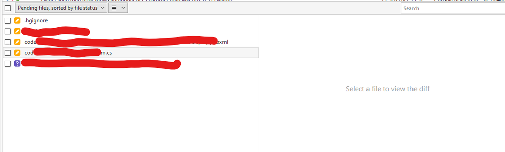

When I select a modified file the diff isn't shown in the adjacent pane, it just says "select a file to view the diff" even though I have selected a file. Some files correctly show the diff but others don't.

Good question. My colleague and I are evaluating Sourcetree 3.4.12 and both of our installs are affected. Sourcetree is at its defaults, using the embedded Mercurial 4.8.1, which surprisingly appears to be the latest one available. Trying to use a system Mercurial seems to fail, although there is no error.
We first thought all files were affected, but my colleague noticed the side diff works for .hgtags.
