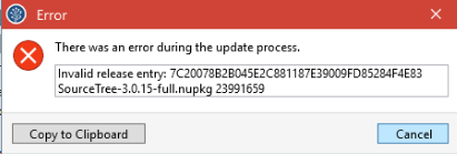

There was an error during the update process (3.0.5).
Dmitri Peredera
September 30, 2018
This happens when updating to the 3.0.5.

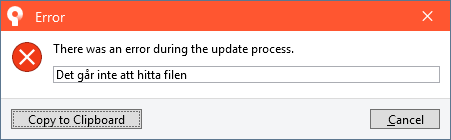

Harsh Chadha
December 24, 2018
What is the resolution to fix this: Screenshot_1.png
minnsey
January 25, 2019
Hi
I've not seen this error before. Maybe the RELEASES file the is downloaded and contains the update definition was corrupted when downloading?
Are you still experiencing it?
minnsey
October 1, 2018
Hi
Sourcetree's Squirrel for Windows update process has the ability to use delta files to download and install only what has changed, potentially making an update smaller and quicker. However it looks like one of the delta's was corrupted during the upload to our publishing server. I believe we missed it because we were testing a  different installed version as our starting point to update and it didn't pick up the corrupt file.
We've re-jigged the releases files this morning. everything appears to be working correctly with our testing now and updating from 2.6.10, please try again.
