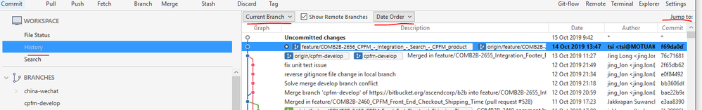

This feature works fine for me in version 3.2.6
Select from the main menu: View => File Status View => select in filter combo-box "All" (instead of Pending files, for example) => select the desired file => Select "Log selected..." in the context menu.

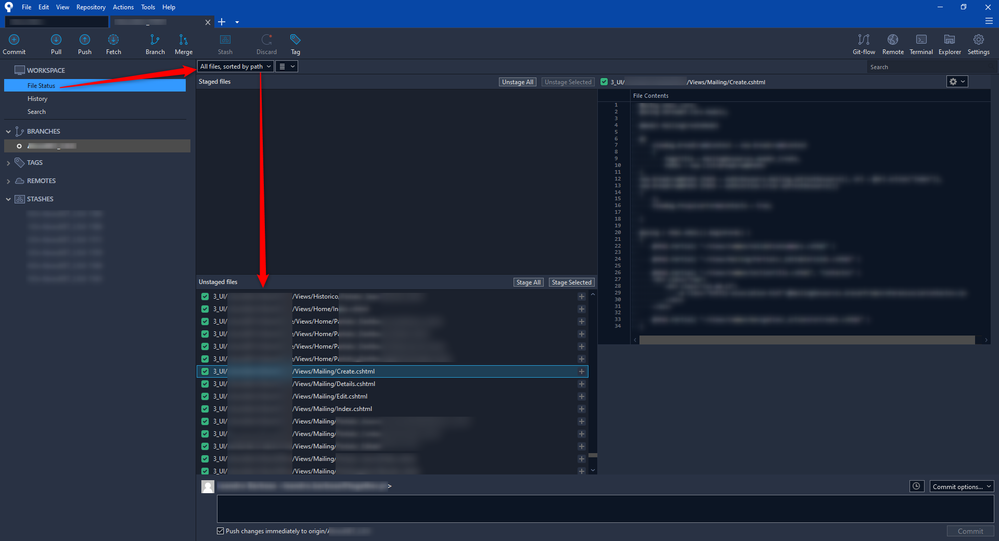

Quentin Stafford-Fraser
January 3, 2017
If you go to the 'File Status' view and change the pulldown which selects which files are visible -- it's normally on 'Pending' – to 'All files, sorted by path', then you can see everything whether or not it has a pending change.
You can then right-click on a file and do 'Log Selected'.
(This works on the Mac, anyway... can't speak for Windows)

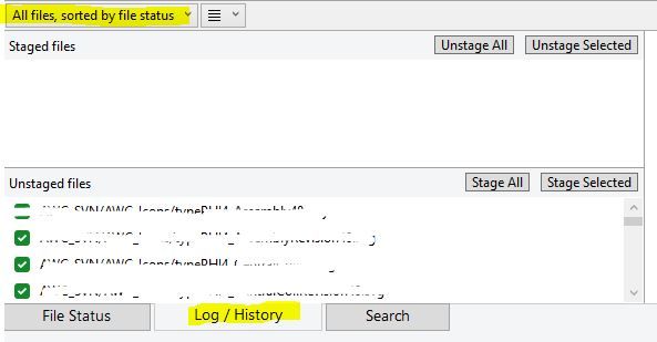

Siva Sundararaj
February 4, 2019
It works fine. Go to "Log/History" tab and select "All files" and use any sort. It shows all the files irrespective of selected commit. You can then right click on the file and select "Log selected" to see history of changes.SourceTreeAllFilesLog.JPG
