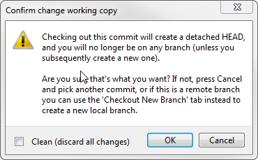

But when I use Sourcetree's dialog it seem more that it only add a remote branch to my local working copy and make it the active branch. It updates the files in the working directory to match the version stored in that branch.
It doesn't matter on which tab I click it shows me only existing branches. The only difference is that Checkout New Branch doesn't show the branches what triggers the warning shown at ther very end of this post.

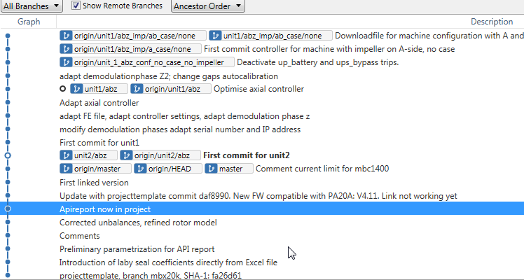

When I want to switch to another commit I double click on it what will download it to my local copy. In my understanding that what happens when I do Checkout new branch.
When I want to changed to an already copied commit I double click it also but this time I do Checkout existing branch.

When you double click on commit that is NOT the HEAD (the end or last commit) of a branch you will checkout that version of the code but with what is called a detached HEAD, it is not a working branch and there is no where to commit and push changes to.
If you right click on a commit that is NOT the HEAD of a branch you can create a new Branch from that commit.
If you double click on a commit that IS the HEAD of a branch, if it is a branch you have opened before and all of the commits have already been Fetched to you r local machine you will just be asked to switch to the branch. If you have never opened that branch or you are trying to open it from commits you have not yet fetched down to you machine you will be asked to potentially open a new copy of that branch
