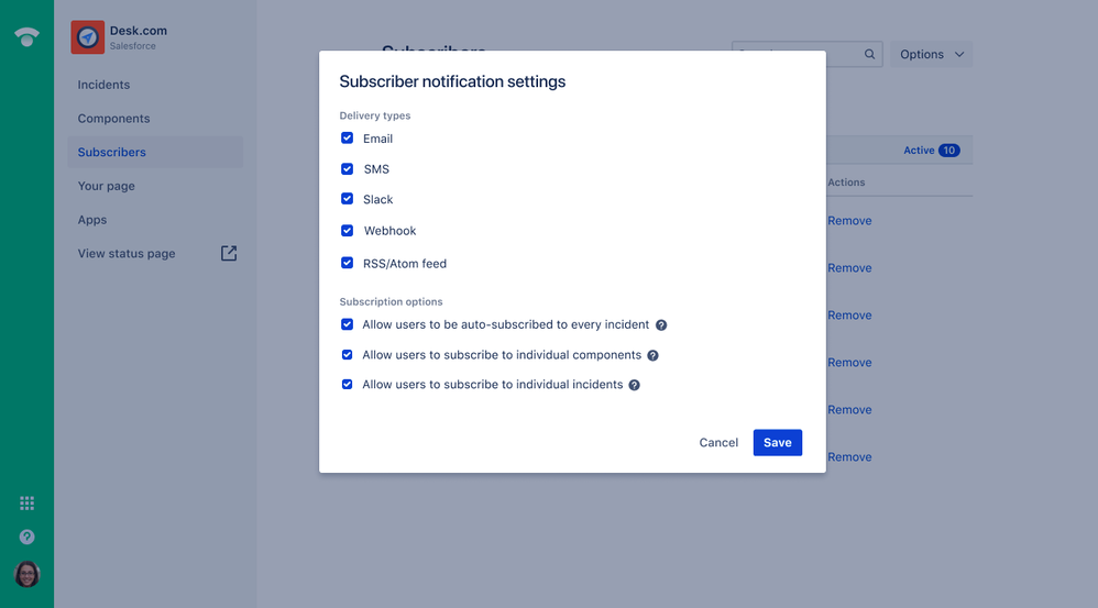

We have a subscription available for Slack in addition to the default subscription options of Email, SMS, RSS, etc. This just needs to be enabled for the page first in the subscription settings:
subscriber-settings-slack
Once it's enabled (and component subscriptions as well), then there will be an option to subscribe via Slack on the Statuspage itself:
And - again assuming you've got component subscriptions enabled - the configuration will let you choose which components to send notifications to the Slack channel to about. Full instructions are available in our support documentation .
