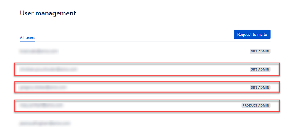

×We have four site admins in our atlassian accounts, and by default all of them are added as users inside of status page. They will NEVER use this product and are increasing our user count needlessly, making it impossible for us to add the actual users we would want managing it without increasing the subscription cost.
Can these admin users be deleted or are they just counted as users no matter what?

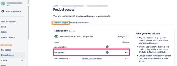

You you now have the ability to remove “site-admins” and "administrators" from having product-access. Please check for product access under site-settings.
See screenshots below: you'll want to remove the "site- admins and/or administrators" group-under options- from both product and admin access (make sure it's both!) and just double check that those users are not in the "statuspage-users" default access group.
This should allow you to make sure that site/org admin are not clogging up any user licenses on SP. Feel free to reply here if you have concerns and/or reach out to support as well.

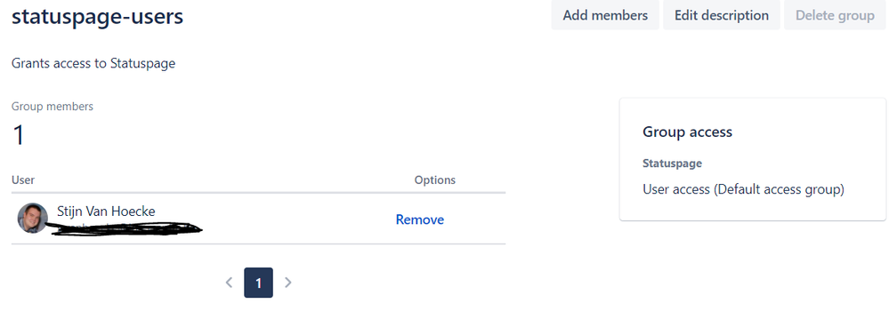

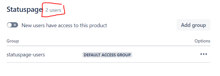

Yet both still say "2 users" on the product access page... where does statuspage pull this second user from?
Users in the user group:

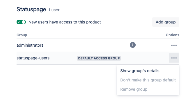

Hi Stijin,
You should be able to delete that member from statuspage-users access group by going under the 3 dots to the right and clicking show group's details.
You should be able to to remove them from the statuspage-users groups. They may have been added at some earlier time.
Let us know if you have any other questions, and of course feel free to reach out to support as well.
That's the issue... as you can see in my included screenshots, that access group only has 1 member (=me)... yet it still says "2 users have access". The other user that has acces is nowhere in the users nor administrator group. So Statuspage gives access to that user, even though they are not in any of the access groups.
