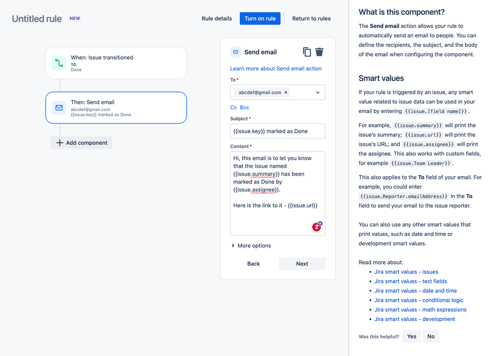

Hi @Gwen Coveny , thanks for posting the question! A very valid scenario. I have tried to put a skeleton that may help you get started below. You can put in conditions such as only IF "Jane" transitions an Issue to "Done" or that email Bill only IF the Issue was transitioned to Done for a particular custom field such as Team = Marketing or IF Linked Issue is each other. You might have to dig through the Automation guide for the specific variables and rules but I'm sure this should get you a starting point!
Another easier alternative without the use of Automation would be to link the two Issues as a "dependency" and add the relevant people as Watchers. For Example, Issue #1 assigned to Jane needs to be completed before Issue #2 assigned to Bill can be completed. In this case, you can add Bill as Watcher of Issue #1 (while Jane would automatically be a Watcher of Issue #1 as she is the Assignee) and mark Issue #2 as dependent on Issue #1 which will show you a relationship in the Issue Detail View for both Bill and Jane to be notified when Issue #1 is complete.
Let me know how your progress :)

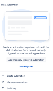

When I go to automation settings within a specific issue (shown below), I can go to Manage Automations and click "enable" next to my new notification. Does clicking "enable" apply the automation to the specific issue I'm viewing? I can't find a way to verify if it's been enabled for the issue or simply enabled as a new rule.

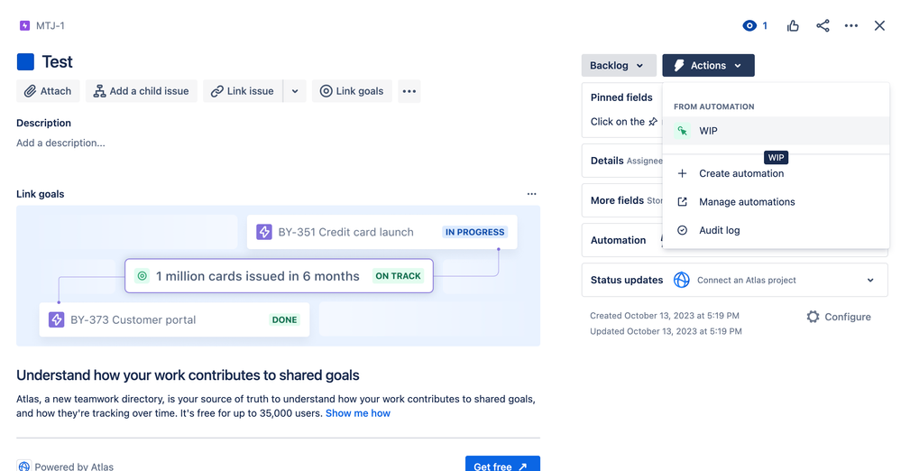

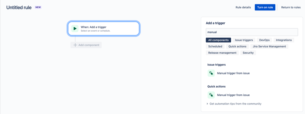

Hi @Gwen Coveny , Glad it has worked! and great question on manual triggers. So you can create the trigger as "manual trigger" as a Quick Actions I've show in screenshot instead of automatic triggers. This will add a button on an issue under Actions.
For example, I created a rule called WIP which when clicked, will trigger the automation rule to run and only when clicked :)
I believe Automations are within a single project only so you will have to recreate the automation in another project to use separately however I could have limited knowledge on it so would seek further input.
Let me know how you go!Screenshot 2023-10-24 at 9.12.45 am.pngScreenshot 2023-10-24 at 9.15.50 am.png

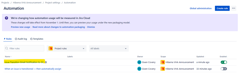

@Mitul PanchalThanks for your suggestions. I am unsure how to apply a rule I've already saved to the project. For example, I created a rule called, "Issue Transition Email Notification to GC" (purpose: when an issue is transitioned, employee GC gets a notification"). This is working properly when I transition any issue in the project. But I want to apply this rule only tocertain issues within the project. My goal is for each issue to have a rule that triggers an email to the person assigned to the next upcoming task in the project. I can't seem to find a way to selectively apply the rule I've created to a single issue. It seems to apply globally to each issue in the project (in screen cap 1). Is there a way within an issue to select a pre-created rule for that issue only? None of the options in screen cap 2 seem to allow this.
