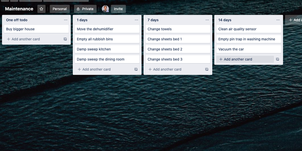

Firstly, you set your board up with lists named "X days" like this:

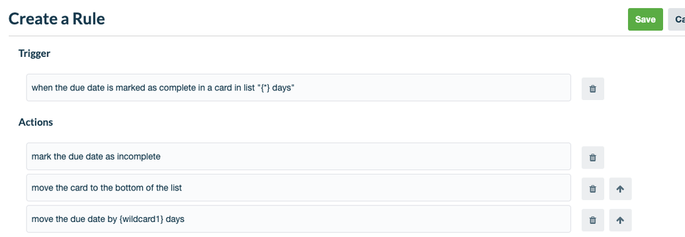

Now create this Butler rule:

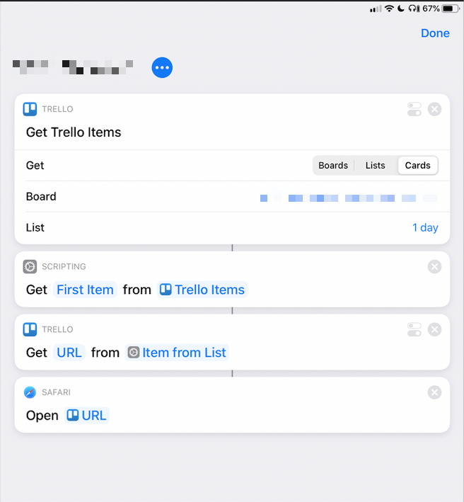

Finally, create this Siri shortcut, and copy it for each list, for example you want a "1 Day Chore" shortcut, a "7 Day Chore" shortcut and so on:
Don't worry, Safari will open the Trello card URL in the Trello app!
Now when you have a bit of time during the day you can say "Hey Siri 1 Day Chore" and it will open the first card in your 1 Days list. The first time you run it, just set the due date to now, then mark it as complete.
Butler will move that card to the bottom of the list and advance the due date the required number of days and mark it as incomplete. The next time someone runs the same shortcut, it will grab the card from the top of the list and so on.
