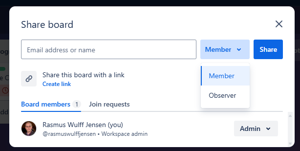

I've just tested in more detail, and I think I know what's going on here:
Trello Version | Add Existing Member to board | Add Member to board via Email Invite |
Free |
Observer = ⛔ |
Observer = ⛔ |
Paid | Observer = ✅ Normal = ✅ Admin = ✅ |
Observer = ✅ Normal = ✅ Admin = ⛔ |
If you change your query param to 'memberType' instead on 'type', you are essentially just leaving out the type, and the API default to 'normal', so that is not the solution.
So why the fails?:
So there is no bugs or wrong type in the API. Just the same logic as the Trello Interface

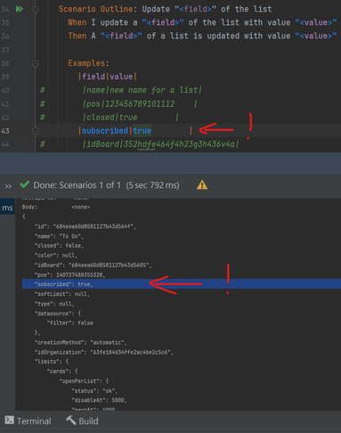

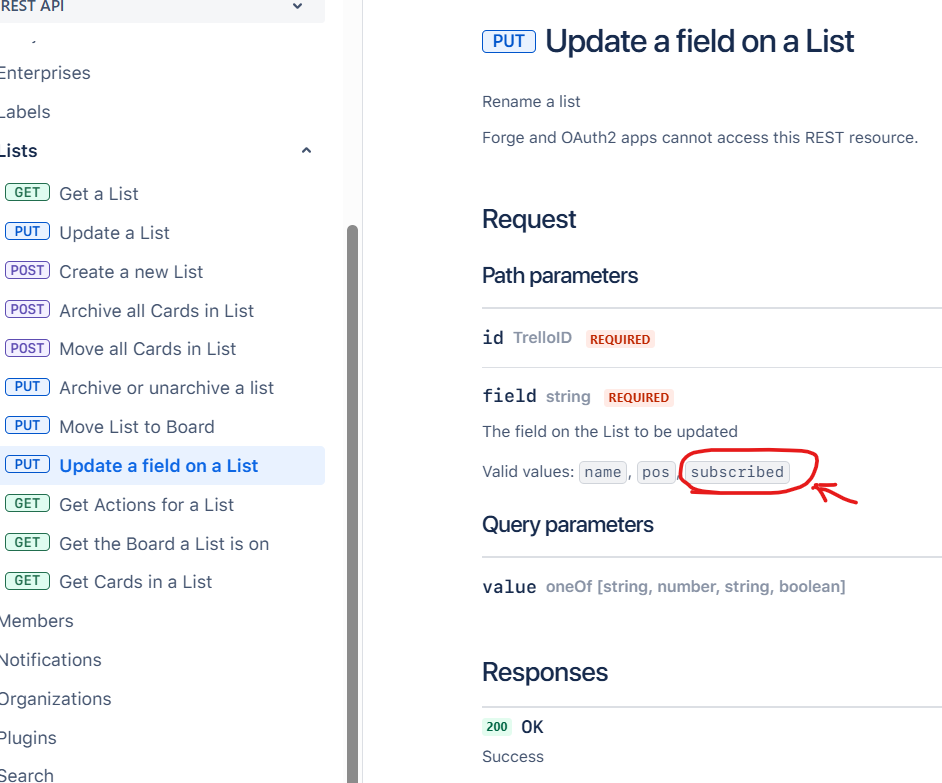

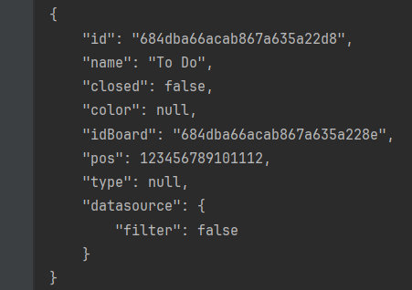

Hello @Rasmus Wulff Jensen ! Can I ask a question about API call "Update a field on a List".
Update a list
These Api call allows to update fields on the list. One of the option (fields) is 'subscribed'. But I can not see such an field on the list
When I send 'subscribed' with value eather true or false I am getting back 200 status code. But when I try to retrive back such a field I get null. Then I try to send any word instead of valued field and I get 200 status code back.
So it looks that theris no field 'subscribed' and API did not show any error message about wrong query parameters that is being send to server while use API call 'Update a field on a list'
But maybe I dont understand something.

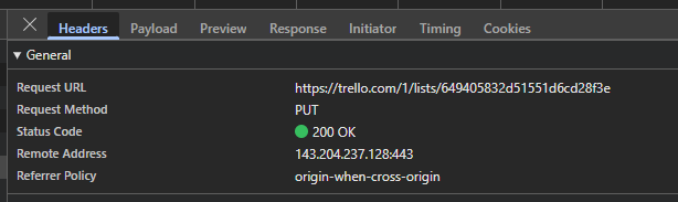

Here is how you subscribe:
PUT
https://trello.com/1/lists/{{listId}}?key={{key}}&token={{token}}&subscribed=true

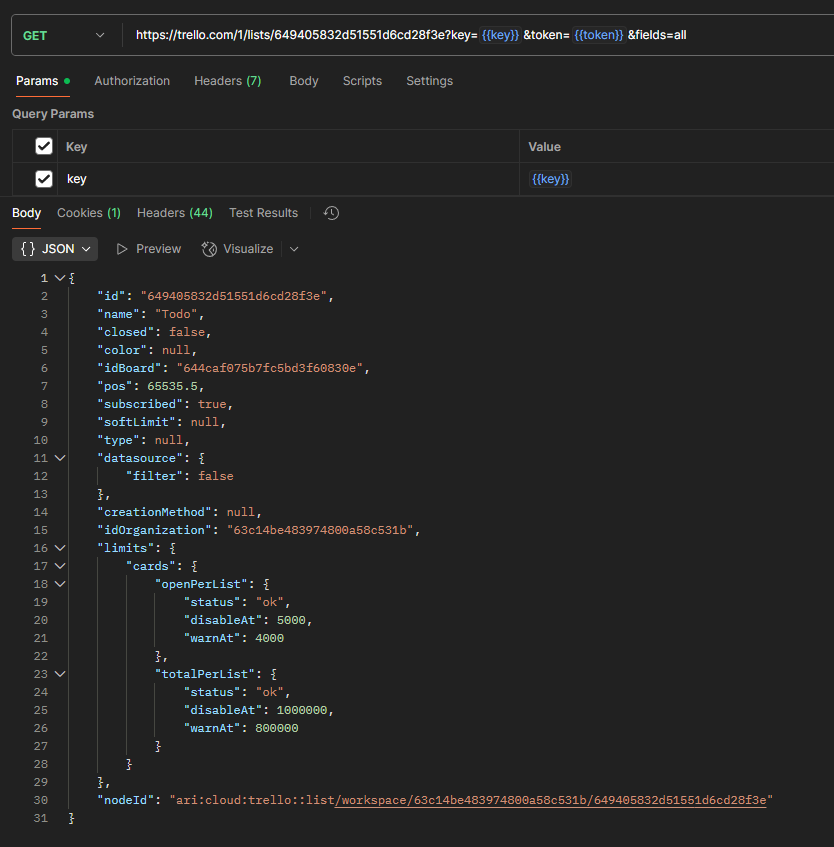

Here is how you get the data back:
GET
https://trello.com/1/lists/{{listid}}?key={{key}}&token={{token}}&fields=id,name,subscribed
or
https://trello.com/1/lists/{{listid}}?key={{key}}&token={{token}}&fields=all
(to see everything)
In general, "&fields=all" will reveal tons of extra fields on almost any Trello object, so a good way to find/debug

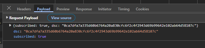

Another good way is to use Browser Tools on Trello.com, as they (Trello) are internally also using this API:
The possible 'type' value for Member is: "admin", "normal", "observer" (or "ghost" for a member already invited but have not accepted but invalid in this case)
Endpoints
https://api.trello.com/1/boards/{id}/members/{idMember}?type={type}&key=APIKey&token=APIToken
Or
https://api.trello.com/1/boards/{id}/members?email={email}&key=APIKey&token=APIToken
Please note that the calls need to be 'PUT' and not 'POST'

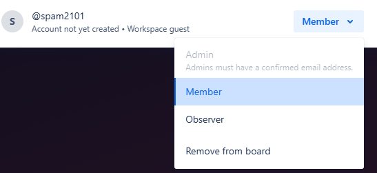

Hi @Dmitrii
Can you confirm what member type you are trying to add?
It may be that you are trying to invite as observers? If so, observer is not a valid member type for the free Trello subscription and is only available in paid versions.
This is an optional parameter. Does it work if you don't set that?
