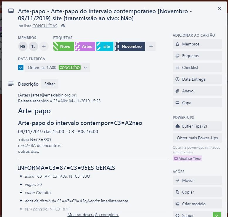

Im experiencing a similar issue using Google Forms.
The problem resides on how the accents are showing on card.
We are experinging this issue for about a month, nothing has changed at the form.
You can see that the title of the card is correct, but not the content.

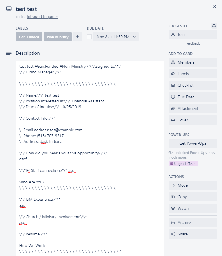

Like the previous author, I'd like the backslashes to go away so that the markdown works for formatting bold text.
Hey Ramanuj,
Sorry for the delay. Hrmm that's very interesting. I can't really say for sure why the backslashes are suddenly being added to your card description, but that would explain why the formatting is not working.
Currently, backslashes are used to escape the markdown formatting, so formatting characters like asterisks will be displayed literally, as you've found!
Would you mind reaching out to us at support@trello.com so we can have a closer look at the Wufoo form as well please?
