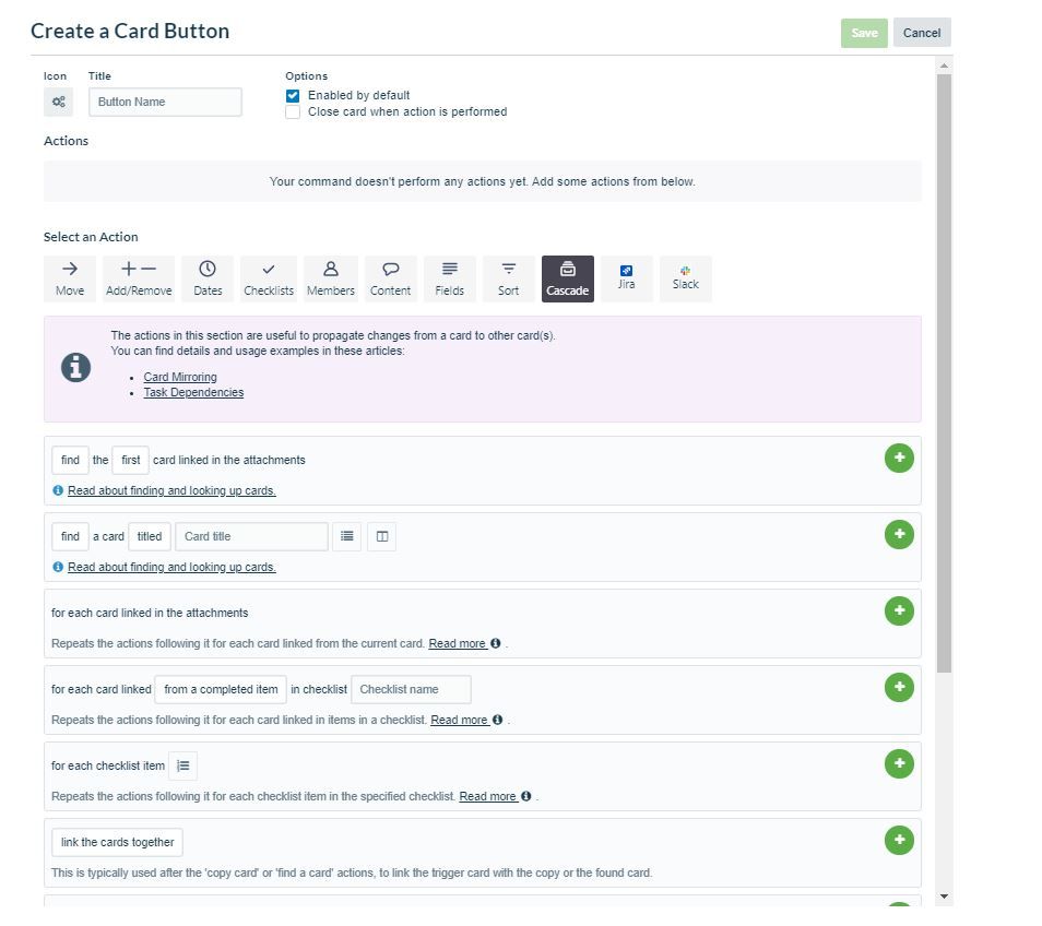

Nice work. My issue is I still can't find 'Collect All Cards' within Butler. I see Rules, Card Button, Board Button, Calendar and Due Date. Within those I don't see collect all cards anywhere. I also don't know where to enter this code?
@Brett K. Collect all card is under rules after adding a trigger, under Cascade - it is the last command on the list.
I don't have that option. When adding a trigger under Rules my options are Card Move, Card Changes, Dates, Checklists, Card Content and Fields
@Brett K. See pic. You might want to ask Trello since you have Business Class. By the way, is the board you are working on is on a Business Class Team?
so according to my Billing info I have Business Class and I thought this board would automatically be part of it. I do see 'Cascade' under my 'Card Button' menu item...
